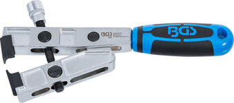

For the stainless steel boot clamps we use this tool here in Europe, 3/8" torque to 30Nm
