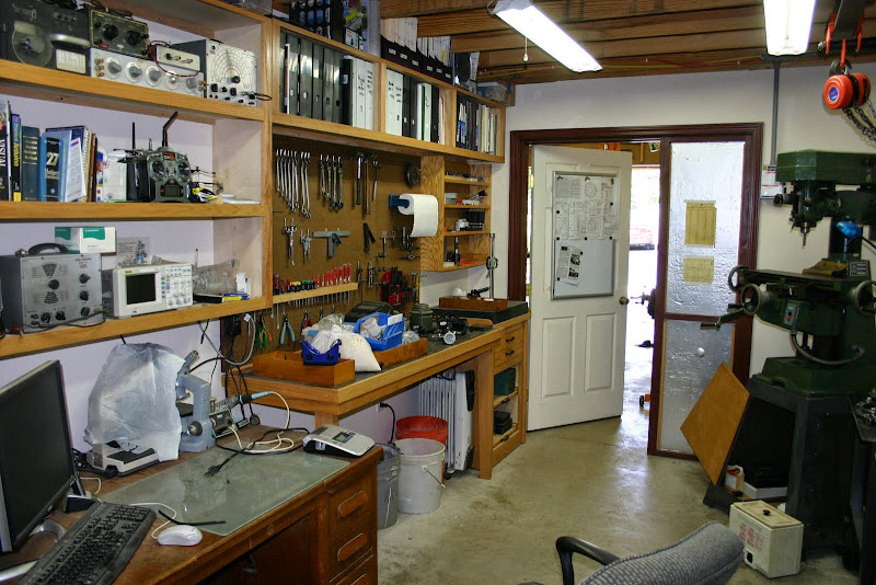

Great workshop. It looks to have a good layout with some room to grow. The one thing that I would change is to get the grinders out of the metal shop. Grinder dust and machines with 'ways' do not mix. The dust will soon take all the precision out of the mill and lathe. I would suggest moving them out into the welding area.

You would think that it has plenty of space but after using the shop for a few years we are talking about a small (~200 ft2) expansion for some new tools.
The grinders are pretty much only used for sharpening tooling for the lathe/mill and probably get used less than 1 hr/year. They act more like tool post grinders than anything and due to convenience they will probably stay where they are. We also keep the metal tools clean (remove the shavings and don't let fluids sit around) which should reduce the wear rate.

Here are a few more pictures of the inside of the shop and a few better pictures of some stuff already shown.

The computer and electronics station.
