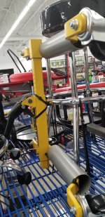

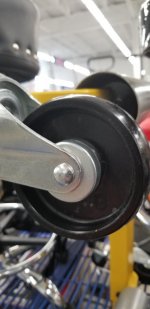

I looked at the new Daytona version and i think the casters have bearings unlike the old ones. I did a spin test and the old one stoped spining very quikly and the new ones kept going a while.
