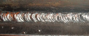

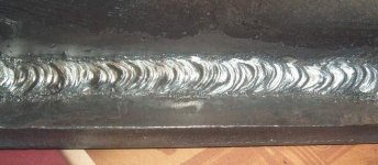

Ok, no gospel but thanks. I havnt ran this but am interested, I bought a little Forney in this class but my bet is this might be better. I was poking at Hobart to make an entry level machine like this.
I might try the Forney on a 30A circuit but it trips the breaker on a 20 and is really limited to 6011 at 3/32 to work. I suspect this may be a better machine, its more expensive and it weighs more. While 90A isn't much work can be done with it, that's really all I use my Maxstar with. It would be worth watching to see if this runs a 1/8 6011 or a 3/32 7018 without a trip.
Here are the Forney pics, its about as good as the machine gets in terms of power. The thing really heats fast, dan comes on about at arc strike and is really blowing hot air at the end of a rod, the Max rarely comes on during a rod.
1st, 1/8 6011, next 3/32, 3rd 3/32 7018 and 4th same size but 7018AC. Its a little better with the AC but this is at the top of its power and is a struggle, operator really has to work to keep it going.
My only reason for suspecting at this point the Century may be better is weight, the F was 7#, the Max about 11 or so.
A little scale on the plate didn't help the little ******.

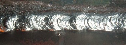

As I mentioned I have a passing interest in the newer cheaper models and where the cost meets the threshold of being useful.
A good share of the worlds work is actually done small electrode. I fix a forklift the other day, 10 minutes of actual welding and about 4 inches where it needed a second pass and it was vertical, about 3 or 4 rods extra on the whole job, took less time than rigging a bigger machine and was a lot easier.
I saw a test on a Longevity by a top hand that looked good, run several rods without tripping the breaker. There is a green one that hits the price range of about 3 or so that I bet works spiffy. Its 1/3 the cost of a Maxstar.
Here is a shot of same rod as Forney but more power, at least 5 amps which in a smaller electrode may mean a little. Kind of wobbly but very fluid. This one was overhead though. In fact both overhead and if I did it regular like might like a couple A to this.
