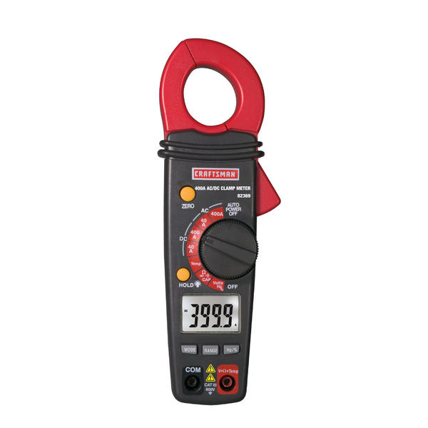

I HAD a craftsman, I'm not sure exactly what model. It looked like this.
spin_prod_1113787012
I would NOT recommend it. AC current wasn't anywhere close to the reading on my fluke. Don't remember ever using DC on the clamp.

The Extech looks likes the Craftsman I had.
I use the Craftsman frequently to check for leakage current in a car.
It may not be very precise, but it's good enough to differentiate between normal and high leakage.
The only problem was the label wearing out and I put a marker on the DC current point.

I have worked with a meter very similar looking to the Extech /Craftsman pictured above but from different brand I believe. (cant actually remember). If memory serves the DC Clamp is not useful at lower amps and in addition I found the milliamp readings in said meter to be shaky to say the least. Granted it's been thrown around a busy shop for several years. Grain of salt and all that..
