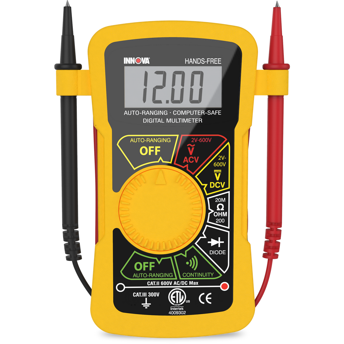

Not DC only but meters don't get much simpler (or cheaper) than this...
