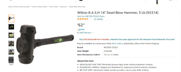

I was surfing Amazon one day and came across a Wilton 3lb dead blow for $26 so I bought it. I haven't had it long enough to put it through all the tests, but it's the most impressive dead blow I've ever seen and that includes Trusty Cook, which is very impressive in it's own right. Here's the 2lb from Zoro, I'm sure you could find bettter deals elsewhere..
I think they went up in price 😮
Yes they did. There was something weird when I bought mine. It wasn't going to ship for a month or so, but I didn't care. I wasn't looking for a new hammer when I found it anyway. Ever other BASH had the pricing more inline with what's out there today. Like I stated, I was just surfing around and stumbled upon the deal, so I jumped at it. I figured the worst case scenario was I wasted $26, but it turned out to be one of my better purchases. The BASH lives up to it's name. Bad *** Sledge Hammer.
EDIT: I just looked at the order. $24.83, ordered Aug. 21 and delivered Sept. 8th, a week or so before it was supposed to ship.
EDIT#2: I was in the shop and took a look at my hammer. I'm guessing mine was a factory second. There is absolutely nothing wrong with it, but the lettering on the handle is black, not green like the picture shows. I really don't care, and, knowing what I do now, wouldn't have a problem paying full price for it. There is no way I would have paid $62 for it without having at least put my hands on it in the store though.
