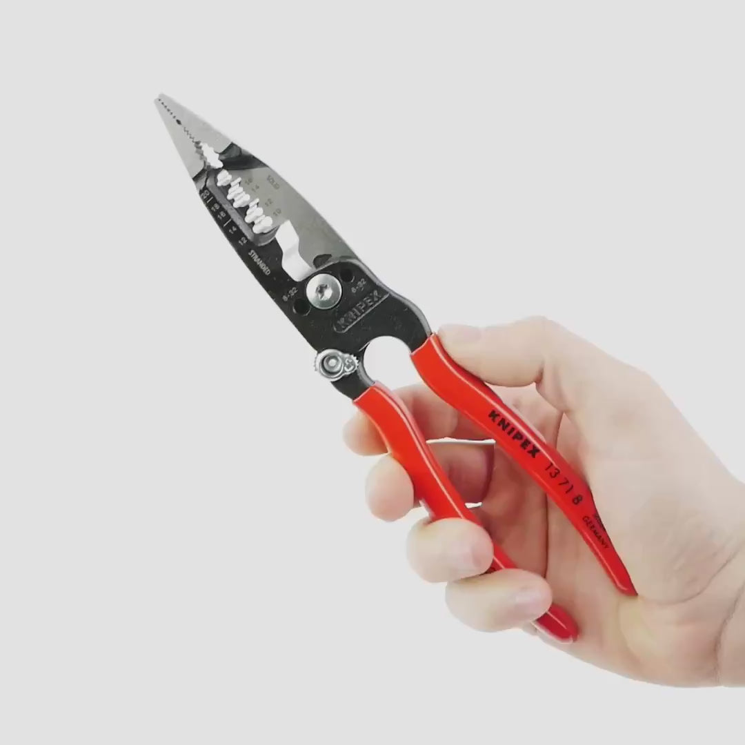

Are the Knipex wire strippers decent quality? If yes, which model works well with fine stranded aluminum wire? Thank you for the help, everyone. Merry Christmas!

Knipex makes very nice strong tools which take a lot of abuse (until a certain point off course). For me they are the first choice.

Yes knipex are well regarded for electricians especially.
Plier choice depends on what you are used to. Personally I like automatic pliers. I think Knipex has a couple of the plastic style automatic pliers that are very common among electricians. The style I like the most is the all metal ones that look more like regular pliers.

Outside of the Knipex electricians pliers linked below, I haven't seen anything they make with a stripper so I can't make a well informed comment about everything. I can say that the above mentioned pliers aren't worth a pinch of **** as a stripper. They do strip, but not as well as a tool that is made for the sole purpose of stripping and cutting.
I've been stripping wires for 29 years, April will make 30 and I've tried a few different types of strippers. Without fail, I always end of going back to the old school Ideal T-strippers. There are at least three types so that anything from #32 up to #8 can be stripped. Day to day I use the T5 which covers 18-10, but there is the T6 that strips 16-26, the T7 that strips 24-32, and the T8 that covers 16-8. They also have the curved handle style that other swear by. I've tried those and they work as well as the old style, but I just don't like them.

I've got all manner of wire strippers but these are 100% the best I've found (better than the Knipex Versions)
Shop around I got mine for £20 on Amazon
They work awesome and lock in the closed position for storage, spare blades are also available.

That tiny stuff is not aluminum wire; it's tinned copper.
Solid large gauge aluminum wire is sometimes used for supplying power to buildings. Kinda the opposite of what you're doing.
Copper-coated fine strand aluminum (CCA) wire in large gauges is also used in cheap jumper cables to deceive the unwary. It's coated with copper and looks like copper unless you look very closely at the cut ends, or hire a lawyer to sift the fine print for the term "CCA".
Anyway... if you KNOW what gauge wire you're working with, and that it's good old 'merkin AWG, and you can see the size markings and accurately target the correct hole every time, then the olde-fashioned strippers with an assortment of sharp-edged holes in them work well.
However, if you're working with a variety of unknown and unmarked wire, and it's sometimes metric gauge wire, and it's often that teensy-weensy-beensy stuff found in electronics, LEDs, etc. then an automated stripper will give you the best odds of consistent success.
This Irwin, for example. It works great, but the head is rather bulky and you need a fair bit of free length to work with. It works well in some situations, but not others.
Another good style was mentioned above, the plastic-handled "puller" style. This is the Knipex version, but there are many different brands selling the same basic thing. This fits into some spaces better.
