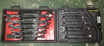

Well I’m no connoisseur when it comes to tools, it would be the same as asking me to give my opinion at a wine tasting, The fit seemed good, I put it on the fitting on the HCU and with one turn it was loose, I didn’t feel any slack in it. I never really looked closely until I took a picture to post here, and after zooming in on the picture I can say the chroming looks a little pitted. Not sure how that compares to SO or other high end brands though. IMG_6970.jpeg
