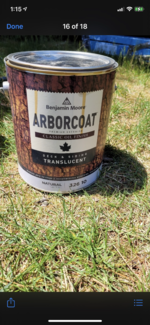

hefnerconstructionlc
Nov 1, 2016
665
Kansas
Cabot, sickens / PPG, Ben Moore arbor coat
All three are premium stains. And just like all the other semi-transparent none are going to superlast too long. That's just the nature of it. Especially if it's in a flat orientation. 3 years service life 5 years max. Probably one to two year of maximum performance. I recoat my deck surface pretty much every other year.

I'm working on a quote now for deck I built a couple years ago. Recommending using BM woodluxe oil-based (I believe Arborcoat is being phased out and replaced with Woodluxe). PPG Cetol (sp?) may be one of the best but expensive and you can't recoat with anything else after you use it.

Benjamin Moore arbor coat. New boards about 5-6 years ago recoat every year.
Arbor coat looks great lasts one season looks wise and 2-3 protection we apply deck cleaner, pressure wash - lightly sand and re stain yearly I’m told only one coat the second coat will peel one rolled coat and back brushed while very wet. Those were the instructions from store.
