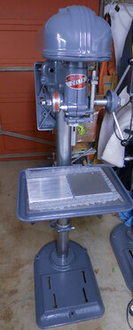

So, I recently picked up this old Delta drill press for a "fun" restoration project. It's from 1946 and I believe it originally came with power feed based on the odd L shaped motor mount and a few other differences. It spend its most recent life as a dedicated tapping machine.
462373591_1550078482549398_3149380698509850071_n.jpg462403249_1528375211895185_5150086602507533625_n (2).jpgdeltapowerfeed.jpg
Phase one was complete disassembly. It was actually in pretty decent mechanical shape and the only part I needed to source was the three spoke quill feed handle. The most miserable part is the cleaning and paint stripping. I used Citri Strip. I learned that the key to using Citri Strip is to ignore their instructions and use it in colder weather. I coated all the parts and threw a tarp over them. 48 hours later most of the old paint was curdled up and fairly easy to remove. It took another application to get what was left.
Here are most of the parts after stripping and painting. The column was sanded from 80 grit to 600.P1110537.jpgP1110538.jpgP1110539.jpg
The large production table only had a few holes that I filled with JB weld. As some point two additional holes were drilled and tapped to 1/2-20 and blocks were mounted under the table. The blocks included open ports to clear out debris. I decided to leave them. They might come in handy for clamping arrangements.

I decided to use a 3 phase 1HP Delta 86-920 and VFD. The motor was filthy buy cleaned up nicely. I has Bayphoto print a new aluminum nameplate.
The quill/spindle assembly/and motor bearings were all rebuilt. Ultrasonically cleaned inspected and packed with Mobil Polyrex EM grease. The DP bearings were New Departure and the motor bearings were Hoover. All were in perfect condition once cleaned. I refuse to replace these quality bearing as long as they are good.
I was able to restore the depth guage dial and nameplate.

Thank you. I used charcoal gray Rust Oleum spray for the DP. For the motor, I used Rustoleum Satin Black and Krylon Rust Tough Battleship Gray.
I'm almost done. The VFD is a Teco L510. It's programmed to display actual spindle speed at the highest speed belt setting. I also set max. frequency to 90 Hz which can overclock the motor 50%. (The bearings can easily handle a 50% overclock.) I added a remote control panel for start/stop and speed control. There's also a main power switch and pilot light. The switch has three positions REV, OFF, FWD. (Rev might come in handy for L.H. drill bits.). I just need to add a chuck and legend plate for the switch. P1110554.jpgP1110566.jpg

Yes, all painting was rattle can.
Yes, VFD parameter 00-12=90 allows up to 90 Hz controlled by the potentiometer. (default is 60 Hz). From all my research overclocking a 1750 RPM motor to 2X is considered OK. I chose a more conservative 50% overclock. That gives me a usable spindle speed from 150 to 3300 RPM all using the highest speed belt setting. At 150 RPM torque is pretty low but at that point you can always get more torque and even a lower speeds by moving the belt down from the highest speed position. (there are 4 lower speed/higher torque belt settings to choose from)
The motor draws between 3.5 to 4.0 no load amps between 150 RPM and 2200 RPM spindle speed as reported by the VFD. When I run it at 90 Hz/3300 RPM amps actually drop to about 2.4. (Not sure the theory of why?)

For the motor, I used a combination of CRC QD Electronics cleaner spray and mineral spirits with a toothbrush. It took a while but worked pretty well. Don't use anything stronger or you risk damaging the windings insulation coating. The bearings came off pretty easily with a gear puller. These three phase motors are very easy to work on since there's no centrifical starter to get in the way. I rebuilt the original Hoover bearings. (I prefer to keep quality OEM bearings whenever possible). Vintage DP's almost never have worn out bearings.
I found a generic Delta motor nameplate image online that was a pretty close match and used Photoshop to modify it with the actual data/wiring diagram from my original motor. (vintagemachinery.org has a large collection of images in their wiki). I used Bayphoto to print on aluminum with their direct on metal printing process.
