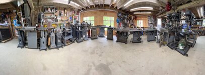

I have been cleaning out the rat hole and had to move some of these machines around so I thought I would push them together for a "Delta Family Portrait". Hard to get them spread out enough for a group pic in my small shop but you can get a good idea of the verity of wood working machines that Delta produced.

What is the big table saw? We used to have a couple of RT-40's where I worked years ago, they sure commanded respect but were a joy to use!

Ho Lee ****!! You have an astounding set of Delta machines, and most look like you lovingly restored them.

Awesome Collection! Gotta ask...what's the favorite? And don't tell me there isn't one....

Firstram: the big saw is called a Delta 12/14. It can take up to a 14" blade. I believe it morphed into the RT-40 later in life. And your correct, it is a joy to use. Especially when cutting large stock.
Very nice collection.
What’s the manufacturing date between the oldest to youngest?
Captain: Sorry, I really don't know. have to look. Most of the machines are from the late 40's to probably the 60's. The Rockwell Unisaw is probably the youngest being 1985.
Wow, never thought about favorite. All are usable machines and do get used periodically, some almost daily. The Rockwell unisaw with the Biesemeyer fence gets used all the time mostly because of the fence but I guess the favorite would have to be the 14" bandsaws or the drill presses or the......:)

Lafester: You have good taste. The 17 is a great drill press made even better with the T slot production table from a later machine. There were a LOT of the 17's made in all types of configuration for a lot of years so there are a ton of these to be had. I would love to have the 17" in a 2 headed cast iron table model if I only had the room. :)

I could have almost made one like that but instead I went with a variable speed head and the smaller clamp table. I sold the t slot table although I probably should have kept it around. I only have a few foot feed parts gathered so far.

Lafester: As far as the foot feed goes, it doesn't get used that much. Seems to be pretty useful if your doing multiple holes, or constant down pressure for big hole, but most times it is just in the way. I have it on both the 17" and the 14" and for most operations I still use the hand feed. Varable speed would be nice and I have kept a 17" 3ph (not shown) around to use a vfd with but haven't found the need to set it up yet.

Tool_Scrounge: The T slot caused me quite a bit of concern for it not being original to the this machine. But in the end I thought I would get more use out of it this way than with the standard table and I do. So I kept the original table for the next guy. :D
Thanks everyone. It has been an ongoing project for quite a few years and hopefully will continue for a few more. :)
There are 25 Delta machines in these pictures and I think only 19 have been completed (not counting the planner which is my current project) so you can see I still have a few more to go. Here's a better pic of the "grinders" spread out a little.

Tarnished - I just went thru the same delema this weekend with a Delta 31-352 1x42 belt grinder. I have an 80s vintage one in nice shape but with the cost reduced sheet metal table and bar stock idler wheel arm. I ran into a early 70s vintage one in only fair condition with a non-original motor but with the more desireable cast iron table and arm. In the end I decided neither was ever going to be collector grade and swapped the tables and idler arms. I end up with the configuration I wanted and my neighbor ended up with the 70's version I had tuned up at a price he could afford.

I mix and match all the time to get the best possible combination. I've gone through 5 stanley grinders just to get two complete ones with decent badges. For some reason these are always completely beat and missing parts. My 17 delta has parts from 3 different models to get the combination I wanted. My 6 inch sander again has parts from 3 different machines to make it complete and in good condition.

Yea that's what it takes to make a complete machine now. Parts are so rare and unattainable that you have to scavenge parts to get a working model. Frustrating! But the finished product is worth it in the end. This has to be a labor of love as no one is willing to pay for all the time and energy it takes to source the parts and do the repair. Probably why most just buy new and chuck old when it quits. LOL.
My goal is to keep things as original as possible when possible. After all it is only "original" once. But I have no problem making the machine fit MY needs. If that takes 2 or more machines to make it happen so be it. If I can't complete the second donor machine, I am sure there is someone looking for the parts I can't use so nothing really goes to waste. One mistake I made is keeping "original" paint. If I had it to do over again I would repaint ALL that machines in the same color. Oh well, maybe next time. :rolleyes:
