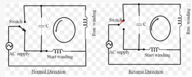

Hi guys!
I just got this Rockwell Delta 12" disc sander for $21 at an auction.
Now, not sure what power it needs as there's no motor info plate on this one.
The start capacitor says 115V.
There's 6 wires sticking out into the box. There were two loose wire nuts in there.
Three wires were twisted together. These are labeled T2, T3, T5.
The wires that I guess were also twisted together are labeled T1, T4, T8.
I've skimmed through this excellent post here, https://www.garagejournal.com/forum/threads/1947-delta-12-disc-sander-restoration.556219/
But his motor had 4 wires with color coding.
Any ideas what this thing needs to power it up?
Note the sticker on top of the disc guard "Thumbslayer."

Often. As I recall. T5 and T8 are interchangeable, for clockwise and counterclockwise motor operation.
As this is a single phase motor, the two bundles probably connect to the 2 lines (from the power cord).
You should also use a 3 prong cord and connect the ground wire to the case of the motor for safety.
You also need a housing or a strap for the capacitor.
Without a wiring diagram it's guesswork to an extent, proceed cautiously.

Yes, it is set up for 120V. T1/2 and T3/4 are the run windings, and T5/8 is the start winding. So one set gets the hot and the other neutral. If it spins backwards, try swapping T5/T8.
For 240V, it would be T1-L1, T4-L2 and T2-3 together. IIRC, T8 gets tied with 2/3 and T5 goes on one hot (but tired now and need to confirm).
Either configuration, the start winding and capacitor only sees 120V.

Not really guesswork but with an ohmeter you can usually figure it out. Almost all capacitor start motors share this basic wiring diagram. Just trace where every lead goes and wire it up. (start winding ohms is > run winding ohms).

Had continuity across T1/T2, and across T3/T4. But across T5/T8 there was only continuity one direction (swapping meter leads) - maybe this is expected.
Wired it up with T2, T3, and T8 to black and T1, T4, T5 to white.
Spun backwards and tripped the 15A breaker. (used a power strip and GFCI outlet).
Swapped T5/T8. Spun backwards and tripped the breaker again.
Got a fat extension cord and moved to a 20A breaker, unplugging the freezers first.
Also swapped which bundles the hot and neutral wires go to.
Now it spins forwards for maybe 30 seconds, but still trips the breaker. Motor never sounded super healthy, like something in there isn't quite happy and maybe doesn't come up to full rpm. Bearings are smooth and spins down slowly. No scary vibrations.
Any tips where to go from here? I've take a couple old motors apart but wasn't trying to put them back together with understanding!
Any idea what amperage or horsepower we're dealing with here?
Thanks guys!

It kind of sounds like your start windings aren't being shut off by the centrifical switch. If the start winding stays in circuit the motor will draw excessive current and not sound right. Make sure your tests are brief or the start windings could burn up. Misalignment during assembly can cause that.

So you should have continuity between T5/T8. You said it spun backwards, both ways (swapping hots)? Did it sound like it ever got up to speed? Wondering if the capacitor is dead or the cent switch isn't set up right.
Current idea: The run winding pulled too much trying to start without help, and popped the breaker.
Disconnect the capacitor and see if T5/T8 each have continuity to one lead from there. That may help to tell if it is the cent. switch, start winding or capacitor.
Just by sound I don't think it ever got up to full speed.
To get it to spin forwards I had to swap the hot and neutral on the power cord; the T5-T8 swap did nothing.

That is weird that swapping T5/T8 bundles didn't swap rotation, but swapping hot/neutral did.
While the capacitor test of "starts at zero, climbs to infinity" indicates the capacitor isn't shorted, it may be weak and helping to contribute to the issues (or may be oversized).
Or this is larger than 1HP (the cap values seem higher to me), so it may be acting correct but pulling too much and flipping the 20A breaker. Do you have a 230V outlet available if needed?
Attached pics from the Rosenberg Motor Repair book I have for both 115 and 230 CW/CCW (a version is available on Archive.org as well).

I think you need to trace where every wires goes and then draw up a diagram for your exact motor. If you feel it's wired correctly and still has problems diasable the centrifical start so the start winding is never in circuit. Now wrap a cord around the motors shaft and turn it on. Pull the cord like you're starting an old fashioned lawn mower. The motor should now be running properly on the run winding. If it's not your problem is the starting circuit. (maybe bad capacitor or cent. sw)
These motors can be pretty forgiving to brief periods where the start winding doesn't disengage but limit it to 10-15 seconds.

Good catch. If he is putting 2/3 and 1/4 together, the two run windings may be out of phase and fighting each other. I am so used to 240 connecting 2/3 together that I didn't question it the first time.

Rosenburg book illustration has 1-3-8 and 2-4-5 (or conversely 1-3-5 and 2-4-8)
Have you tried that yet ?
YES! This did the trick. First time, ran backwards. Switching 5 and 8 did the trick.
Runs very nicely. Had all the kids out there taking turns sanding scraps for maybe 20 minutes on a 15 amp breaker.
I guessed also that previously the start and run windings were fighting each other.
Thanks all for the help. Now it just needs a permanent mounting location and a good switch.
