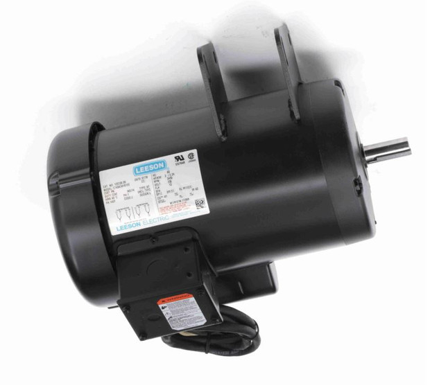

Looking at a 1.5hp unisaw on MP. Claims it needs a capacitor. $150 price tag. I will look at it tomorrow. Serial no. is KD-927 and the model no. 34-461. My question is can it be upgraded to a 3hp motor? Are all the Unisaws upgradeable or just certain ones? Tia

I don't know about all of them but at least some of them use a non-standard way to mount the motor.
I've seen 3HP Unisaw motors in catalogs, not sure but I think Baldor makes them.
Might check eBay, just be sure it's single phase and it's not burned up.
As far as handling 3HP, I'd bet that saw could handle a 10 if it'd fit........

unisaws do not use standard motor frames. They have mounts welded on to the casing.
yes they can be upgraded. Not sure its worth the money as you probably can buy a 3hp complete saw for less than a new motor. Or have a motor shop fix the one you have on it
Someone had dicked up the wiring by the picture above but that is easy to fix.

Yes, they can all be interchanged. But the last time I checked, maybe 15 years ago, a new motor was $600. Someone who is good with disassembly and welding and machining could modify a motor to add the proper mount to a standard unit. It really is just a pair of plates welded to the shell. But the coils would need to be removed before welding. Not an easy task.
My current Unisaw is the fourth one I've had. It was $150 because it is three phase. That is a lot easier to rectify with a VFD than changing out a motor.

i bought a grizzly motor off eBay that was an Amish take out motor. It bolted right on no issues.
the other thing i have seen people do is cut the motor plates off the original motor and weld a mount plate to them.
then they can drill holes and mount a standard flat plate motor to that.
