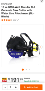

I can see your dilemma and would be concerned that the sledge hammer vibrations would transfer to the floor and walls and would compromise the tile.
My initial thought would be to use a cut off saw. Rent, buy or borrow.
PPE to the max and ventilate the room.

That's a bit of a big gun to bring to this fight, and not useful beyond this one tub. I think I'll stick to the grinder and sawzall.
