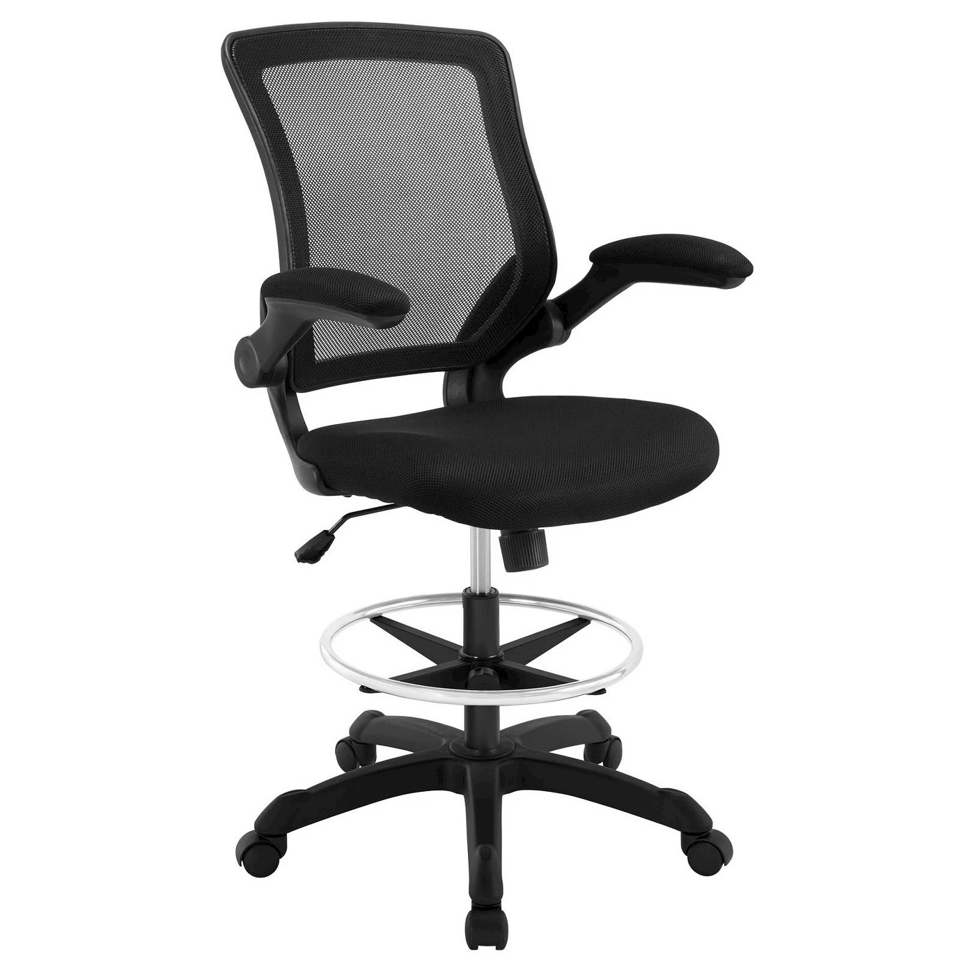

You can get a tall chair with hydraulic suspension, I'm sitting at a 41" tall toolbox typing very comfortably right this minute. I actually prefer a higher chair, it's easier to stand and move from this high chair than getting "up" out of a chair to get going. These will be 21" - 29.5" to the seat.
Something like this:
GUEST_6b0a30df-6eb7-4b1b-9923-f5494765f24c

Sadly, the weight capacity of that chair is less than I am. They do make them in a higher capacity, but they are more expensive than the 2 tool boxes. Plus, occasionally there will be two people sitting at this desk, so then we would need another high chair.
I appreciate the suggestions, but a higher chair is out.
