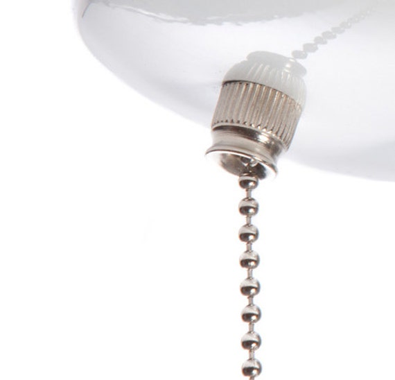

Mechanical solution:
Install a light in your shop, next to a window, so she can see when it goes on or off, and make sure it has a pull chain, like this:
Then attach a durable, non stretching string, to the pull chain, and run it with the wires, into the house.
Bill
