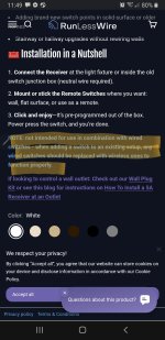

Hi all,
I've got a shop about 100 feet from the home that has exterior lighting for the back yard, currently switched from inside the shop. I would like to add a light switch in the house for these as well. I could run some wire underground to a 3-way in the house but the effort is just not worth it.
I'm aware that options like this wireless light switch exist, but I'm wondering if there is something similar that would be compatible with a traditional 3 way light switch. I'd prefer to only have the remote switch in the home and keep a hard-wired traditional switch in the shop (heavier duty, don't have to worry about changing switch battery, common aesthetic, still have means of operating light if battery or receiver has issues). I've searched but all I can come up with are kits where each switch must be the wireless kind.
If such a switch does not exist, my plan B is to use a non-3 way wireless kit like this to control a SPDT relay that would act as a corresponding 3-way switch to the traditional one for the shop. Attached is a picture of the circuit if it helps anybody in the future.20260316_112222.jpg
