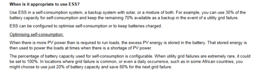

IMHO, "by far" the best way to do this is by throwing a monitor on your main. I use Emporia vue. I know your home is not built yet, but I'd even suggest throwing a monitor on your existing main. The power you use in CA is likely very different from what I use in Texas (climate difference). Design your battery storage so it can "easily" be expanded.
I think you're going to run into an "amps" capacity problem before you have a total storage problem, so the point may be moot. 4.5hp is a LOT of surge power... And even the Tesla powerwalls seem to be limited to 5kW or so each.
Some of these solutions are "inverters and batteries" in a single form factor. Others have separate inverters and then storage systems. You can "parallel" both designs, but it's critical that you design for "flexibility" now if you're going to expand later.. It can save you a ton of money.

The batteries I like (Enphase) have a higher short term output than long term and the system is expandable.
Yes I was planning on that. We could always start with fewer batteries and add as needed (and as the price drops).

One interesting thing is that all three solar/battery companies I have talked to have said that it's normal to run all the loads off the batteries and then you have to go shut stuff off so you don't run the batteries down too fast.
I don't think you're talking to the right person. Modern hybrid inverters can set "power preference" based on a number of things such as battery charge % and time of day. There is no such thing as "run the batteries down too fast" - modern lithium has a ton of capacity and if the inverter can handle the draw, the batteries better darn well be engineered for it.
I asked if code there requires load sheds if the backup does not have the capacity to run everything, and they said yes but it gets approved anyhow. One guy said the inspectors don't really understand battery backup systems.
Load shed modules are for use with generators. They detect low-voltage and under-frequency (low RPM) and will drop out circuits or entire sub-panels.
I've never seen a load shed for an inverter. You only put circuits you can handle on the inverter. If you overload the inverter, it's going to shut down.
Some inverters (again, don't know Tesla) have "grid pass through" capacity with more than one output, which can make things a little simpler.
But the "best" way to design this is to figure out your critical loads, size the right hybrid inverter for them, then add battery capacity to get you the "backup hours" that you want.

Some of the solar/battery controllers the solar companies I've talked to suggested have a few ports for loads that get switched off when on backup power. They are intended for big loads like car chargers but could possibly be used for entire sub panels. That's part of why I'm trying to nail this down soon, so the electrician can do whatever needs doing to match.
dcg9381
Jun 20, 2018
11,887
Austin, TX
I'm working on a separate product with a Victron inverter. This is an interesting feature I was unaware of. It allows you to "reserve" battery for household use and still keep reserve capacity for backup:
