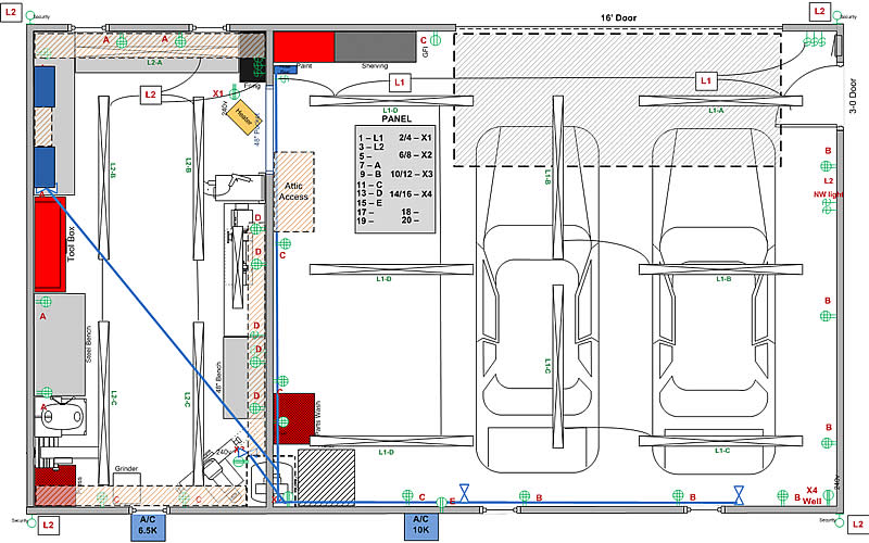

So how do you guys determine what your gonna run for circuits. Heres my issue or question...
All along I was thinking I was going to seperate everything out individually..for example, Garage Door Openers on on its own, Exterior Recept on its own, various circuits for banks of recept's. Now that real world wiring has started, I'm starting to see my thought is going to be wasteful in terms of wire. For example, in one single stud bay I've got a recep. inside and one outside...using my old mentality, thats 2 circuits. factor in that run will go 6" away from the recep for the Liftmasters, and I could use that one circuit and one wire for 5 recepticles. Which IMO isnt out of line for a 20A circuit...and save me a bundle of wire in the long haul.
SO that being said..should I approach wiring the garage more like a house where everything in a room or area is a circuit vs its specific use within reason?
