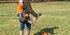

Stihl has some powerful stuff but needs either a back pack or belt battery pack. I guess there is not much difference between a Makita system with two smaller 6.0 batteries and a Milwaukee system with one larger 9.0 or 12.0 battery. Its when you get to 15.0 or 18.0 that things might get interesting
In the quick attach systems Makita and Stihl can change between gas powered and cordless power heads. Milwaukee is just cordless. Like anything each line has their advantages and disadvantages

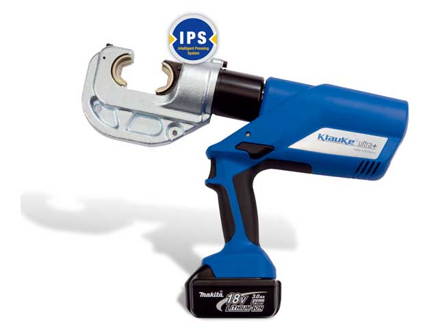

Then I learned that other tool manufacturers use Makita batteries, like Klauke (cordless hydraulic crimping and cutting tools for plumbing) and Greenlee (electrical tools), despite both companies being owned by Emerson, which has their own battery lines... it seemed a pretty sure bet that the Makita LXT platform would be supported for a long time.
