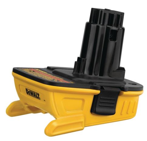

I have an old Dewalt cordless drill that the batteries died some time ago, and I got to thinking there may be a way to resurrect it. I know I could get new cells and rebuild the old packs, but I wonder if there is anyone out there making lithium batteries that will fit/work. It’s a 14.4 volt, using battery type DW9091. Some quick googling turns up a lot of replacement Ni-cad packs, and a few 18v packs that look similar but I don’t know if they would actually work. Thanks.

I don't think a 20V lithium to 18V Ni-Cad adapter is going to work in a 14.4V Ni-cad tool.
Best guess I know would be to get a new 14.4 volt battery. There's plenty of them still available both genuine and knock-offs.
https://www.amazon.com/s/ref=nb_sb_...&field-keywords=dewalt+14v+battery&pldnSite=1
If there was a 14V lithium platform then perhaps there would be an adapter made for the older NiCad 14V tools but I don't know of one. The only reason Dewalt was able to have a newer generation lithium battery to older gen nicad tool adapter is because they are the same voltage anyway so it let people transition from one platform to the other (though they should have come out with the adapter much sooner than they did). It also goes worth mentioning that if there was a newer lithium batt platform that could work you would need a new charger for it also. Probably not worth all that especially for a single tool.

For the price of the adapter kit that comes with 2 batteries you can get one of the promo drill packs for $20-30 more with 2 lithium compact batteries

Not a 14.4, but I picked up one of the lithium battery adapter kits for my ten year old 18v drill.
It works ok, but, in the end, I still have a heavy old drill that works, but is not as ergonomically friendly as the new drills.
I only use it for backup now, but having the old battery pack rebuilt would do the same, at lower cost.
Clever marketing on Dewalt’s part though, as I ended up buying several bare tools to go with my new lithium battery, along with several additional batteries.
