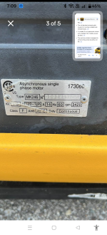

Hey y'all. Looking to buy my first compressor, and I'm hesitant to buy a disposable pancake. I found this ..non-oil-free Dewalt Emglo compressor on marketplace for a hundred bucks that piqued my interest. Guy said that it's well maintained, but power hungry. I'm on a 20a circuit, but I share it with my living room.
Thoughts on how this would stack up vs other compressors in say, the 1-200$ range?
Some things to note - I only need a compressor for occasional home shop use. I don't even have any air tools yet, aside from a blow gun. But I like the prospect of future capability.
Thanks for any insight.

I've got a similar Emglo. My feeling is this isn't the best ~$100 option. What's good is those are very solid, long lived compressors. However, they are also loud, trip breakers rather easily when cold. I like that it takes only a minute to go from 0 psi to full and just 15 seconds to refill.
However, for home shop, light duty use I would probably get one of the quiet compressors from Walmart (or other places). I picked up a Goodyear branded one a few years back. It was really good. The flow rate wasn't as high as the Emglo but having an 8 gallon vs 4 gallon tank was nice. Sure, it took 3x as long to fill up (lower flow rate and larger tank). But, it wasn't as loud thus I didn't care about hearing it run in the background. If I were buying new, low cost, light duty for the garage, this would probably be my first pick
https://www.walmart.com/ip/HART-Black-135-PSI-Oil-Free-Electric-Air-Compressor-8-gal/5135218418
Walmart stopped selling the GY branded unit but this is similar in price and I've found Hart tools to be like Ryobi, clearly cost reduced but quite usable for a home user.

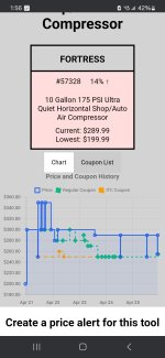

HF alternative to that Walmart compressor has a much higher flow rate and much higher max pressure in a similar footprint. It's also a quiet model. I realize it's more expensive but it's looks like it is frequently on sale or has a coupon.
10 Gallon, 175 PSI Ultra Quiet Oil-Free Horizontal Shop/Auto Air Compressor https://share.google/e0klNtRyBARclS53b
That would be a good, "bit more money" option. More flow and thanks to the higher pressure, more stored air.
That appears to be a a D55152 which has been superseded by the D55154. Looks the same, but with wheels and a bigger frame. Over $450 new at Ace.
For $100, you can't go far wrong. It will NOT run a sander or sand blaster. Impact or short bursts of an air hammer.

As for a shop compressor, they don't have enough volume to do much of anything but nail guns.
The D55154 (which I think uses the same motor and pump as the D55152) will run most 1/2" impacts and chisels (at least for a reasonable burst).
The specs are reasonable
  • 1.1 HP (better have a 20A circuit)
  • 4.0 CFM @ 90 psi
Pluses include oil lubed and cast iron cylinder.
