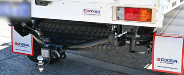

How many diesel Ford Ranger's get their exhaust tip polished?
After cleaning with soapy water from my wheel bucket, which was Megs Hyper Wash today, it was time for an old favorite, P21S Polishing Soap.....................................
Get P21S Metal Polishing Soap Online | Waxit – Waxit Car Care
P21S Polishing Soap for Exhaust Cleaning and Metal Polish – Obsessed Garage
P21S Metal Polishing Soap 10.6 oz Jar - Skys The Limit Car Care
Following that, Dr. Beasley's Metal Coat, which is a ceramic nano sealant designed to protect chrome, stainless steel and aluminum. Metal Coat seemingly tolerates exhaust heat, making it supremely durable, to the point where it never really falls away. Application couldn't be easier, simply wipe the surface down with prep spray, apply a small amount to a towel and wipe it on, then wipe it off. Metal Coat bonds instantly and is said to last 3-years.
Dr Beasley's DB-s32d08 Metal Coat 237ml : Amazon.com.au: Automotive
Dr. Beasleys Metal Coat 8 oz.
Metal Coat | Dr. Beasley's
I love the look of this exhaust outlet. In particular, I like how they cut the end of the pipe to be parallel with the road, almost like someone put some thought into this generally unseen part of the car. Actually, the exhaust is only visible on cab-chassis models.
The latest model Ranger looks awful in comparison, basically a pipe that points to the ground just after the diff. There was certainly no thought put into it other than its basic function.

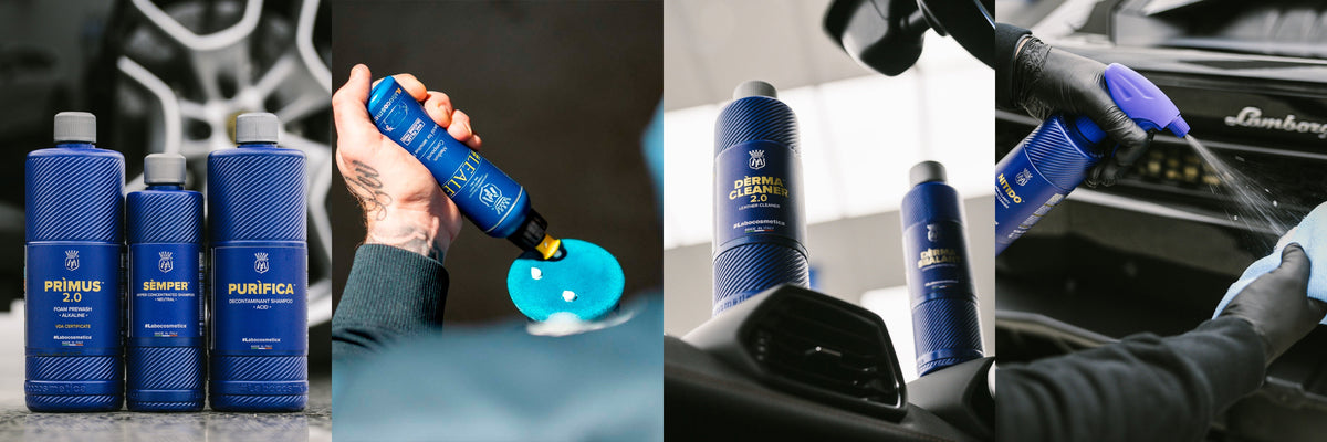

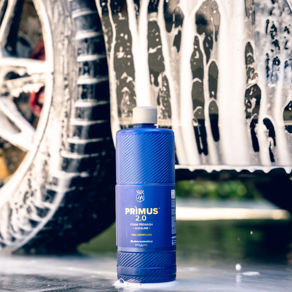

Well, I finally caved and decided to try a few Labocosmetica products.
AU -
USA -
Semper smells absolutely divine, like an Italian aftershave or high-end body wash......................in fact I'm thinking showering with it!
Also, kudos to Labocosmetica for doing smaller sample size bottles.

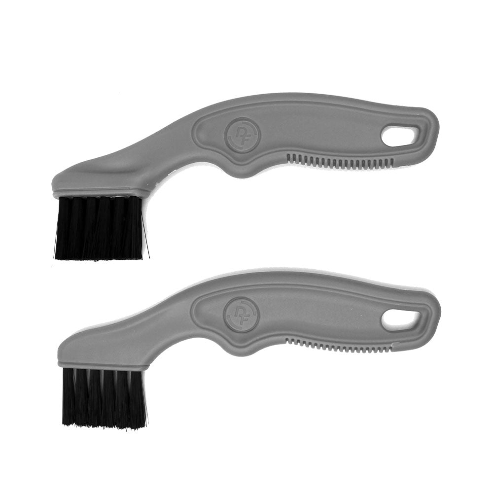

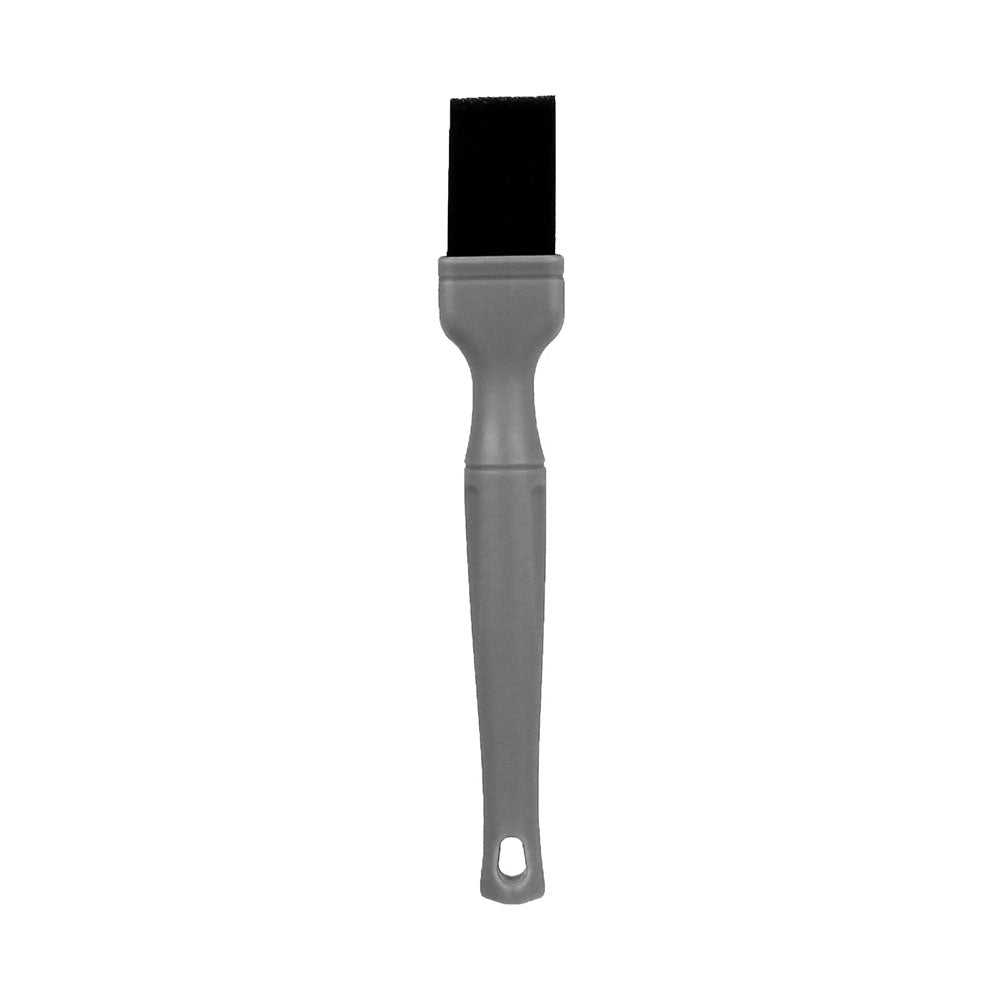

Another day, another delivery...........................
These new Detail Factory brushes have only just hit the market. The foam ones are like those craft brushes, just with a better handle and stronger foam. However, I do wonder how durable they will be. From what I can see, they were designed to team with Solution Finish, which can be very messy to apply.

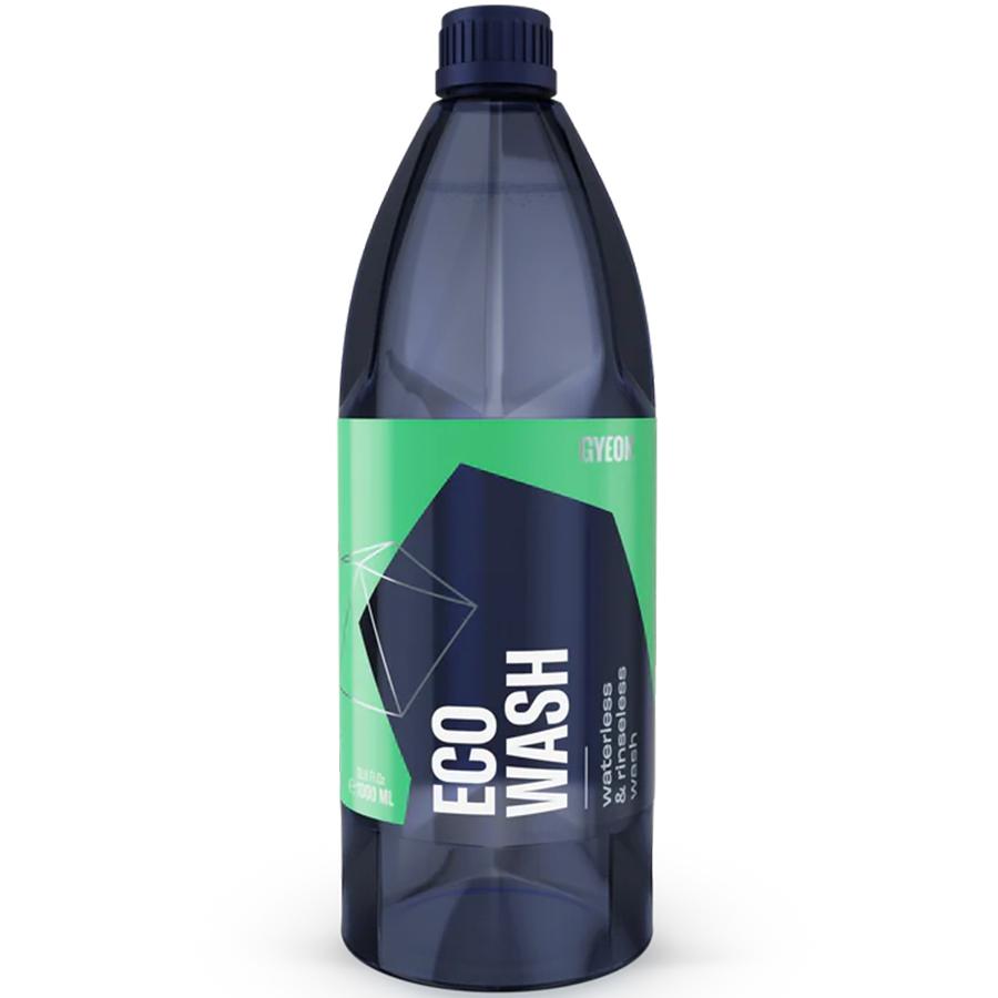

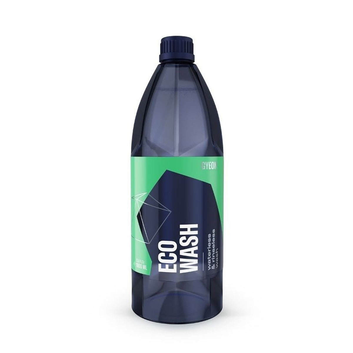

My last rinse-less wash experience didn't go to plan, a week later and things were much better today..........................
Considering the road film and dirt was still wet, and therefore not bonded to the paint, I cut a few corners. First, I went around and rinsed each wheel, then foamed the whole car with KCx Active Foam. While the soap dwelled on the paint, I gave each wheel and tyre a quick once over with a brush, then rinsed the whole car down, followed by a quick blow with the EGO. Moved into the garage, I mixed up EcoWash to the waterless rate and sprayed the car down. From there, my large Gauntlet towels were used to wipe off the EcoWash, and a second dry towel to finish. No drying aid required.
I've only used EcoWash a few times, but wow, what a great product! The slickness and gloss it leaves behind is epic, and like most Gyeon products, it smells amazing too. Oh, and I didn't need to polish the whole car afterwards. ;)

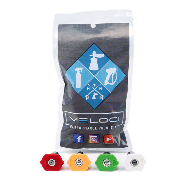

For rinsing with the wand, I use a 40-degree nozzle tip with a 5.0 orifice. That's on a Kranzle KHD-10 that does 2.64 GPM, probably a little more as 5.0 is up a size compared to stock. The tips themselves are the Mosmatic rubber shrouded nozzles. When running the sort gun for wheels, I'm using the same 5.0 nozzle, but with 25-degree angle.
I'm guessing the machine you have is the Adam's version of the Active 2.0? If so, check out the below spreadsheet. The supplied nozzles are 4.0 orifice, but the 5.0 is recommended in the link below, which boosts flow from 1.89 GPM to 2.12 GPM. The other thing you can try is moving from a 40-degree to 25-degree, this doesn't change the pressure or flow, but focuses the output and can help drive soap more effectively.
If it was me, I'd be ordering a 40-degree and 25-degree shrouded tips with a 5.0 orifice. The Mosmatic's are expensive, so I'd also consider the MTM versions.
https://www.obsessedgarage.com/coll...smatic-nozzle-assembly?variant=42925989101719
These are the basic tips -
