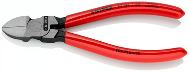

Knipex 72 series - 125mm, 140mm, 160mm (standard, round head, 45deg, 85 deg), 180mm.
Knipex 79 02 125 S1 - special version of electronic nippers for cable ties, with all the edges of the head rounded.

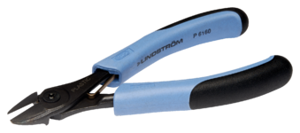

"Ergo" 160mm, seems to be both the Bahco 2101PG and Lindstrom P6160.

Knipex because, everyone needs more Knipex. Heavy duty cutters with good leverage. Preferable for larger/thicker cable ties.

Yellow Lindstrom 8141's for size comparison. Older Swedish made. Lindstrom/Swanstrom is excellent stuff.
