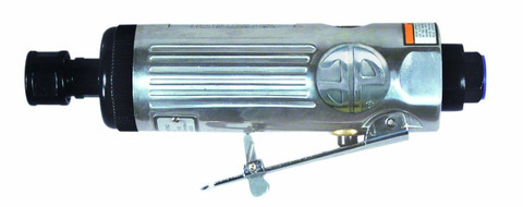

We used the piss out of die grinders deburring large engine cranks, blocks, and rods.
For years we used IR one that were the berries but they were expensive enough that the wanted they guy that maintained all the air tools and torque wrenches to rebuild them.
As production increased they decided instead of making a second position to just go to throw aways.
They tested a bunch and settled on the Astro T210. They would last 6 to 9 months running 2 to 4 hours a day across three shift depending on the operation. They were slightly louder than the IR
From my Amazon perusal, that's a reasonably priced one. The burrs however are spendy! Thanks for the recommendation!
