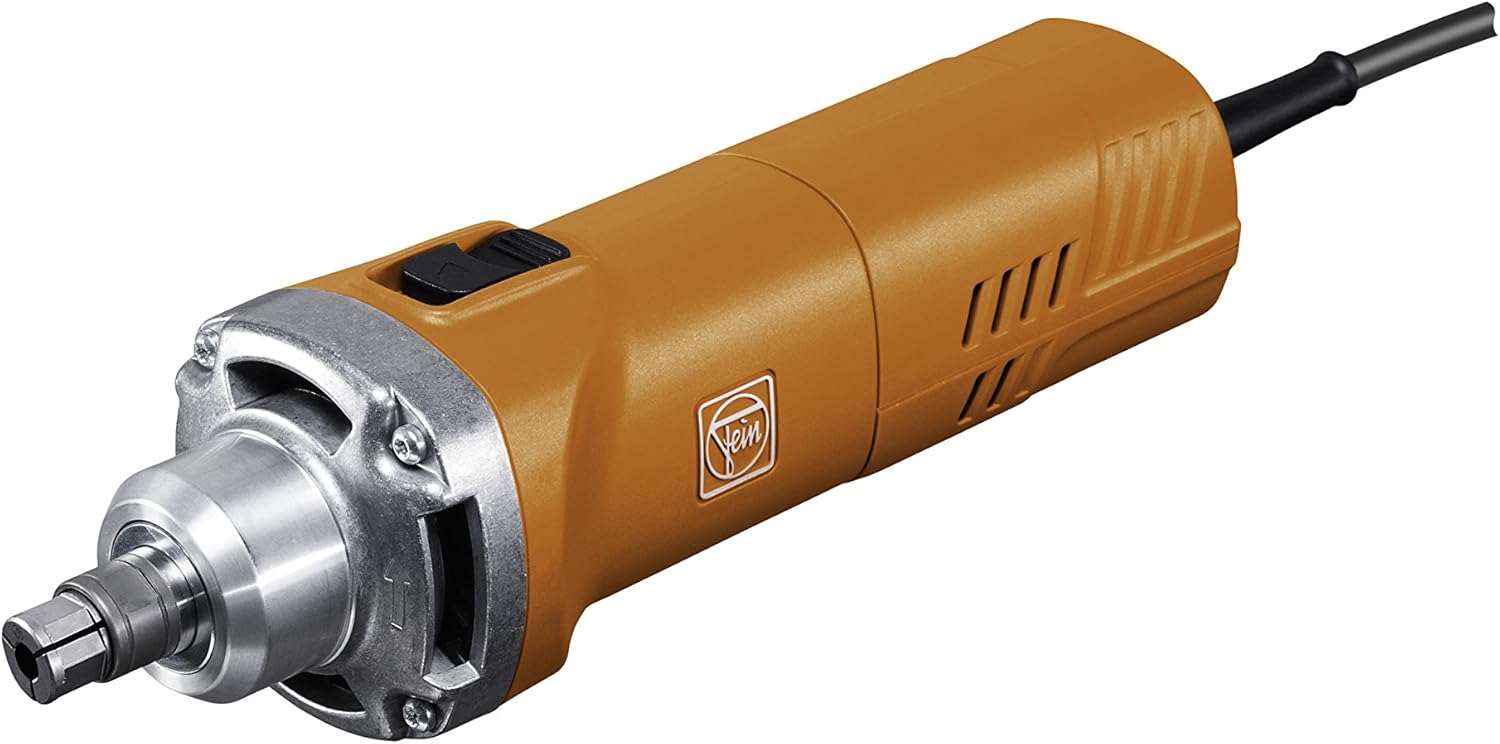

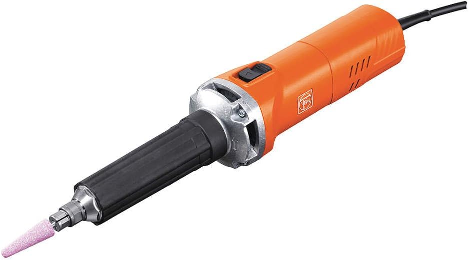

Have a Fein variable speed die grinder, made in germany, works fantastic. They offer both a long neck, and short neck. I have the short neck.
