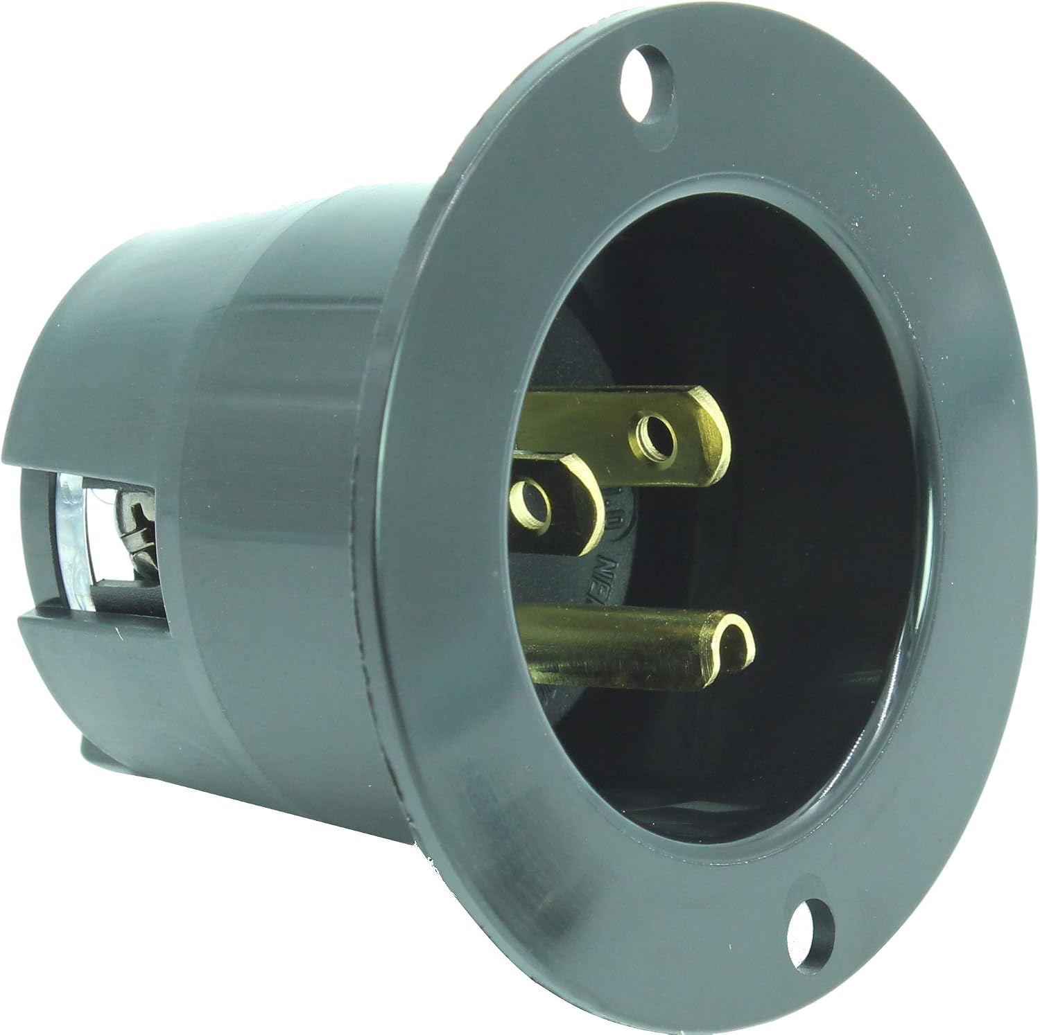

First off, I don't want to set up a suicide cord. I truly want to make this a safe set-up, but I'm looking for an inexpensive way to have it done by a licensed electrician, for resale purposes, but I'm not sure any would do it.
I only have two main things I want to run during a power outage; my well pump and my sump pump. I don't need a whole house generator, I'd rather have something portable and easily replaceable.
I have two 4400w peak portable generators, gas/lp powered. I want to put a power inlet on the outside, something with the basic same function as these below:
https://images-na.ssl-images-amazon.com/images/I/61FsaFCqpML._AC_SL1500_.jpg
or
https://images-na.ssl-images-amazon.com/images/I/71ap7TYFyBL._AC_SL1500_.jpg
I want whatever it is, to be mounted properly, running to conduit on the inside (in my 5' high crawlspace), with an outlet box near the sump pump and the well pump (which would need to be switched to a plug instead of the existing hardwiring).
If all that seems reasonable, I'd like a couple extra outlets run, just about straight up, into our master bedroom and kitchen - just to make life a little bit easier. Minimal loads would be put on these; phone charger, maybe our cable modem and wifi.
I'd run a normal extension cord from the generator to the power inlet, and plug loads into the outlets normally, in my crawlspace.
I'm certainly no electrician, but I'm hoping this could be done affordable, and it would keep things pretty simple. It would be about as simple as a manual interlock/cutout, and I don't see a chance of backfeeding power.
Anybody want to point out the flaws? I'd like it to both function properly, and look decent.

What you want to do is more complicated and costly than an inlet and interlock in the panel with the circuits needing gen power.
Or you could do a branch circuit manual transfer switch like one listed in the below link. less work than running new circuits to certain rooms.
http://reliancecontrols.com/indoor-pro-tran-2.aspx
reliance sells something that is close to what youre looking for, but uses a 240 inlet.
https://www.walmart.com/ip/Reliance...able-Generator-Through-The-Wall-Kit/987368010
I second a regular generator transfer switch could do what your asking easily, be more "conventional" for resale.

Reliance 510C connected to a 30a inlet. 10 circuit capable, and upgradable to 50a if you or a future owner wants to upgrade.
I did this and found that 9 circuits are all I needed. No 240v circuits in my application.
I regret somewhat not installing a 50a inlet with appropriate feed wire and buying a dog bone adapter to suit my existing generator.
Or you could do a branch circuit manual transfer switch ...
Option one all the way !
Lowest installation cost. Most flexible as far as what appliance/equipment you can run.

Go with a Reliance Controls set up.
I disagree. The Reliance Controls set up limits you to (typically) 6 circuits or 1 240V circuit and 4 120V circuits. If is also a bit tedious to install.
A generator interlock does not limit the circuits that are "covered" by the generator and is much cheaper to install. Your only limit is home many appliances you have running at the same time and the size of your generator.

This is something within my skill set. For $90, I can get my immediate concern resolved. I appreciate all the responses, but I just don't see the need for a full on transfer switch right now. This will keep the genset completely separate from the panel; I'm good with that. I only really need two circuits powered.

Just to confirm... both the sump and well pumps are on single, 120v breakers?
The thru-wall device has no circuit protection, so unless I am missing something it would be possible to overload any single plug to the limit of the generator’s circuit protection.
