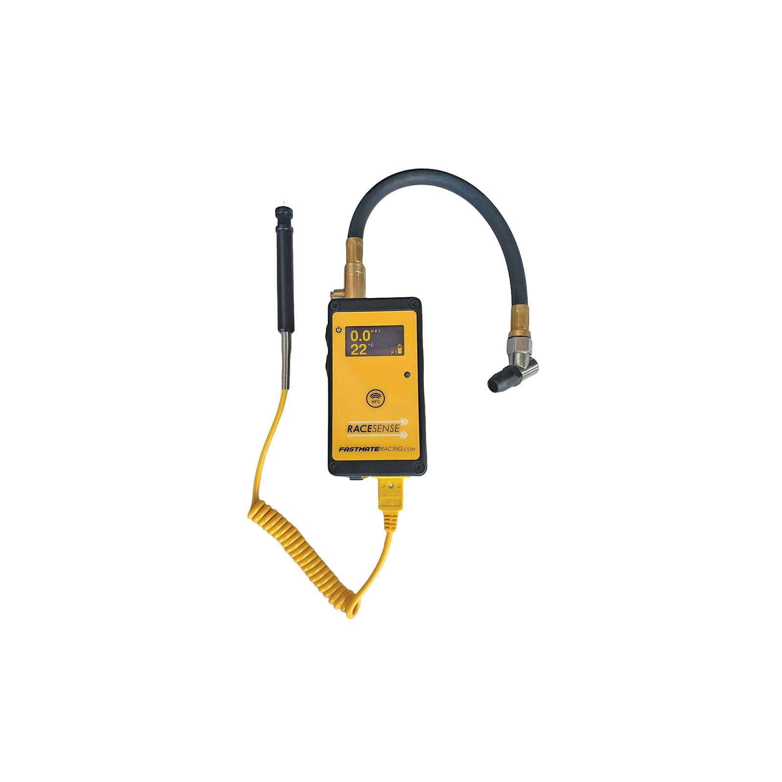

cbracer
Feb 27, 2012
645
Costa Mesa, CA
Money no object, use what the pro's use. My preference for teams is this one:
There is a newer less expensive model:
But many teams also use this one:
