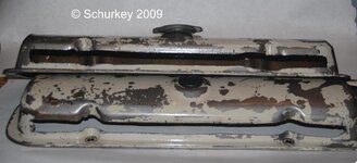

I like to sacrifice a Treasure-Yard valve cover pair, so that I can verify that the pushrods spin. Paint a vertical stripe on the pushrods with a paint-pen, When the engine runs, assure that each pushrod spins. If a pushrod doesn't spin, the lifter isn't spinning either--and it'll wear-out the lifter and cam in short order. (Pontiac valve cover set shown.)
