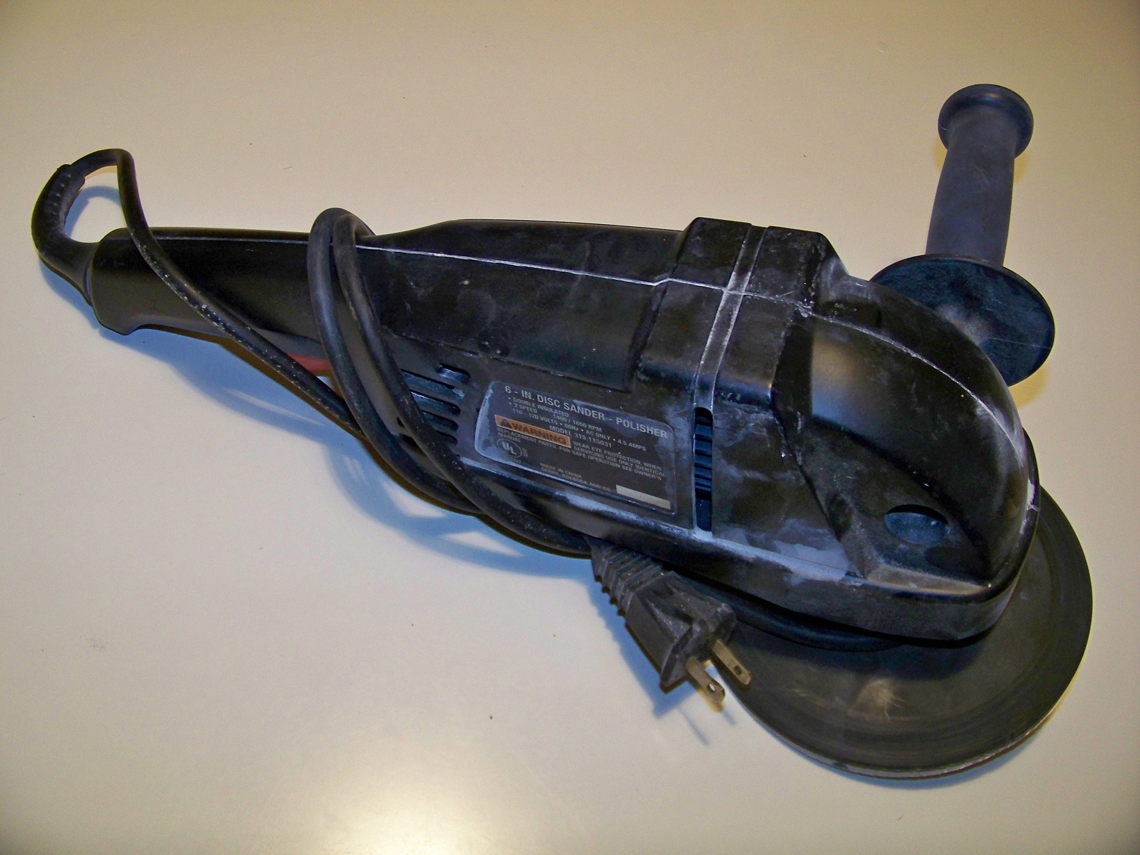

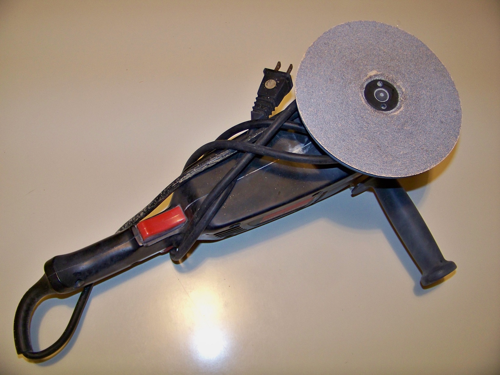

I'm sanding the 100 year old rat shack exterior (thread link in sig) to get rid of lose paint before repainting. I'm using a buffer/sander I purchased some time ago and it works very well (Craftsman model 315.115031). It weighs 6lbs. The longer handle gives me good control.
pics linked to larger pics
One of the reasons I purchased it was I had a fair amount of 6" sanding discs from my really old all cast metal Craftsman disc sander (I was starting to feel current tingling through my arms during use on that one).

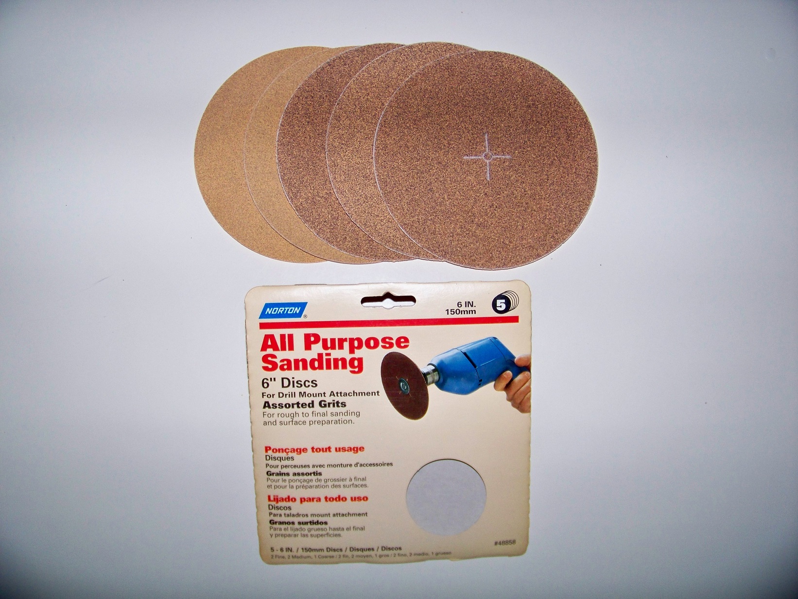

So now I'm looking for more 6" sanding discs and finding that they don't exist - at least not the ones with holes in the middle. I only find the adhesive backed (which I don't think I can use on the existing pad). Here are the discs I have been using.

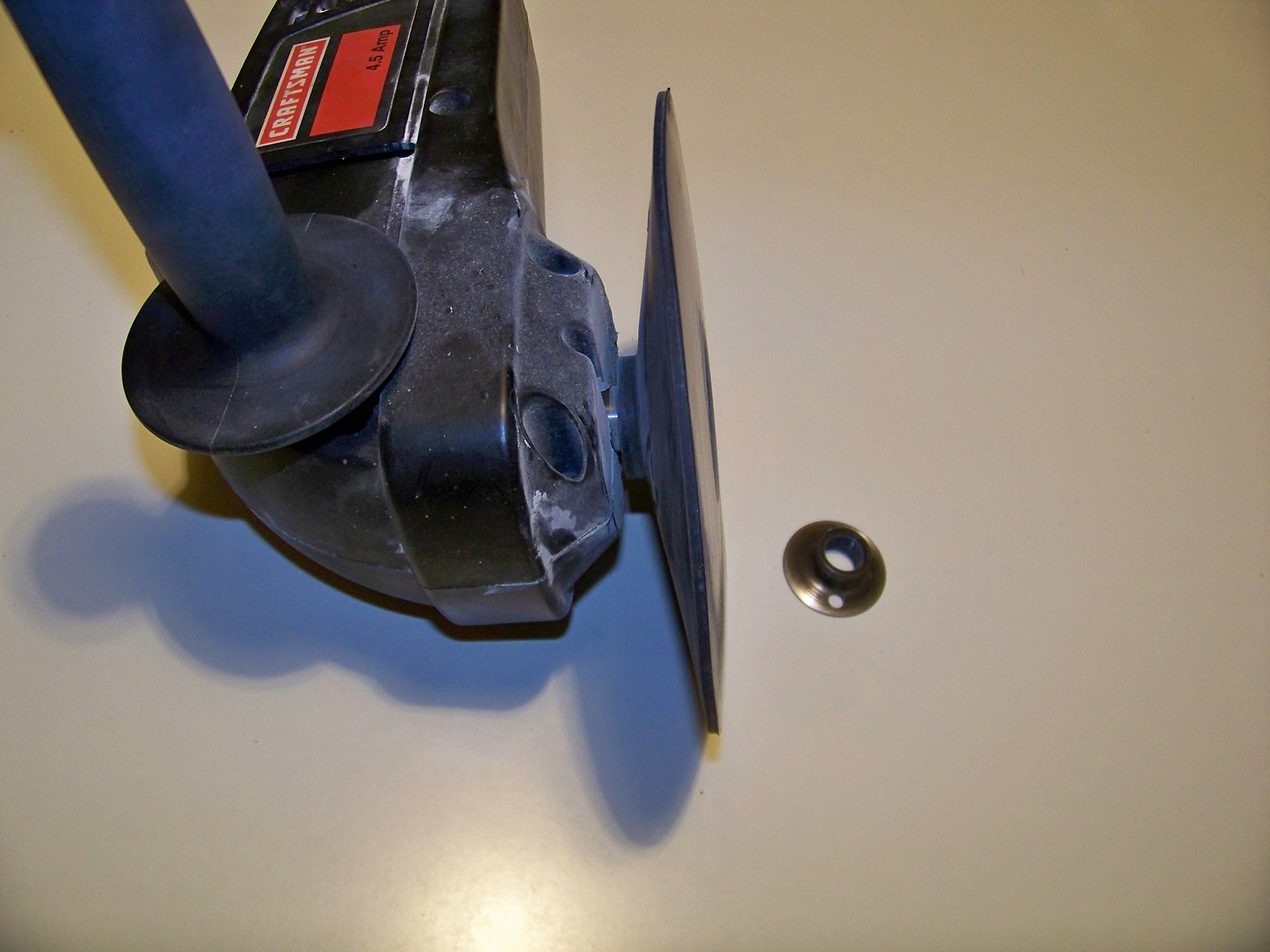

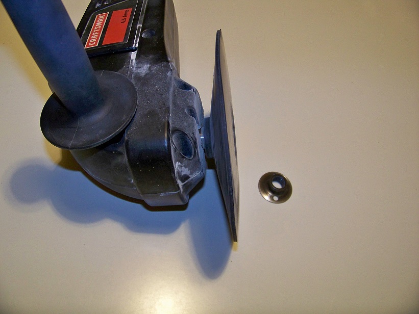

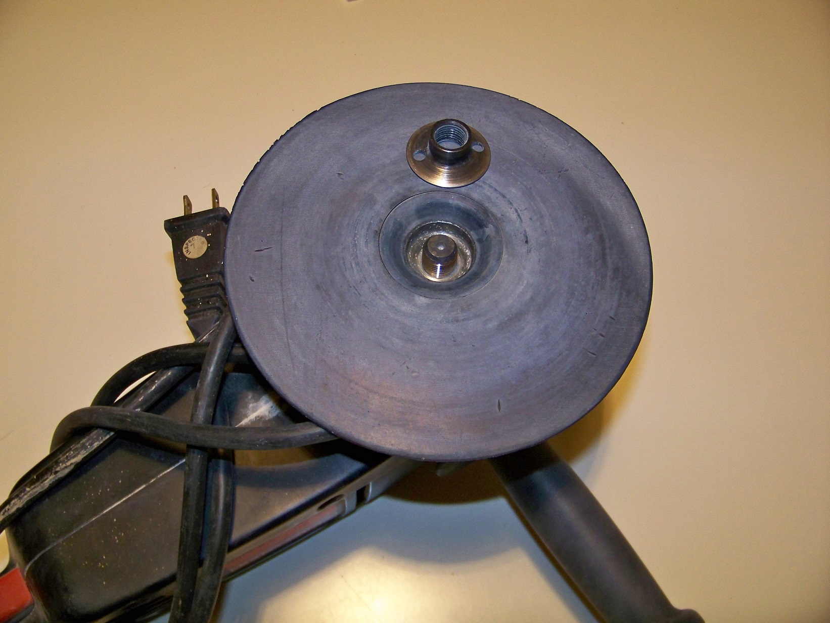

I considered changing the pad to a 7", but the arbor is 1/2-20 thread as opposed to the standard 5/8-11. I actually found an adaptor to change that (link), but am starting to think I'd be better off just buying a new disc sander. I don't want to end up with an unbalanced pad.

A picture of what sandpaper disc you have would be helpful.
how does the sandpaper currently fasten to the sander?

I've never seen a 6" angle grinder before.
Would 6" adhesive paper work? that's very common. They typically stick to a vinyl faced foam pad, maybe you could contact cement on 1/8" foam and vinyl to the existing pad.
That will be less aggressive than a fiber disc though.

Just use 7" disks. I've done this a lot. Yeah, they overhang the pad by half an inch. That's not the end of the world. Alternately, buy a 7" pad.
