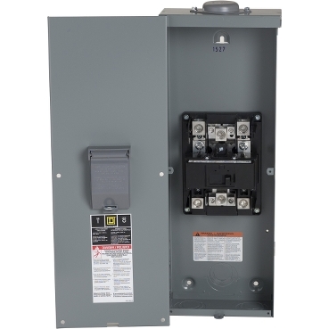

So here is a disconnect I would like to use. Will it work to disconnect the main service distribution panel from the service?
http://www.gordonelectricsupply.com/index~text~974395~path~product~part~974395~ds~dept~process~search
files
It comes with the circuit breaker and lug kit.
I will have a 200A QO service panel. The purpose is to make the main panel dead when working on stuff in it without pulling the meter.
I see it is rated for outdoor use but would like to mount inside.
And will the main service distribution panel then be considered a subpanel and be required to have the green bonding screw removed?

That enclosed circuit breaker would be the service disconnect where the neutral / ground would be bonded, and anything downstream would be a subpanel with a four wire feed.

That would work. But...
You will need to pull a permit.
Bring all your grounding electrode system to it, and you can't splice that stuff so that's all new. So the wire from the water meter needs to land in there, as well as the ground rods. If you have a pipe, plate, rebar, ground ring, or building steel it needs to land there as well.
Pull a new ground wire from that main disconnect to the sub panel. So you have some grounding there.
Pull the bond screw from the panel, so the existing neutral rails will float, and then add a couple ground bars. After that you have to separate the grounds and neutrals because being bonded twice is asking for trouble.
Then have it inspected again so the poco will plug your meter back in.
So... The buss is all dead when you shut off the main and the only thing you could get nicked off are the lugs so just buy some lug covers and snap them over the conductors. That's the new cool they put in panel boards these days now that they made them all mandatory in the new NEC.

Its way more work than youre contemplating.
The feed to your current service panel MUST be changed to 4-wire.
Also the GEC for your electrode as well as the metal water lines needs to be moved to this new disconnect.
A ground bar or 2 will need to be added and the neutral bonding screw needs to be removed. Then all EGCs on neutral bar(s) need to be moved as well.
What type of wire feeds the current panel from the meter? Is it accessable?
That is NOT code compliant unless the existing feeder is in pipe.
If OP has SEU between meter and panel, he will have to run a brand new cable.

Existing feed from the OH service drop, and including the new 200A main service panel will all be new. Then all wiring in the house will be upgraded to grounded and brought up to code.
Present panel is 2 30A main fuses.

That new panel will no longer be the main service panel because of the disconnect.
It will be a subpanel.

Forget the disco you posted just buy a meter pan with 200a breaker installed. They're short money.
Wirepuller
Oct 6, 2014
305
Not sure they're approved here.
I can't see why they wouldn't be. Correct me if I'm wrong but it sounds like you would be installing;
200 overhead service to a single phase meter socket,
200 amp fused disconnect located inside,
Then to a 200 main lug panel?

If you're replacing the fuse box anyway, you're in for some rewiring so I don't see the big deal in installing this disconnect. You'll be installing new 4-wire either way.
Where will the new panel be relative to where the service enters the house? How far in will it be?
I would install it, but I'd put it outside the house.
