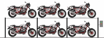

My first post here! I'm looking for a way to get some of my motorcycle collection off of the garage floor and onto a garage wall. I have about 20' of wall to work with, so ideally I would like to have a lift that raises 3 bikes about 4' off the ground, so I can park 3 bikes under those, on the garage floor. I am open to constructing something like a 4 post lift with diamond plate floor and a winch motor to raise/lower the platform. Has anyone seen or built anything like this? Just looking for ideas and thought this would be a good place to start :)
This is the closest thing I can find, but its $2400 and just for one bike.

How tall are your ceilings? I would think that it would be less expensive to set up an overhead trolley to lift the bikes up onto a fixed shelf. It wouldn't be as cool, but would work well. Another thought would be to have the shelf 4' deep and then you could make an elevator to raise them to the shelf, then roll them to the other end of the shelf. Also are these long term storage or is it something you need to get at frequently?
MotoList
Jan 25, 2013
4
I think I like the cool factor of the entire platform raising and lowering by winch :) The bikes would need to be lowered several times a year for cleaning and starting (and riding).

I could probably learn to weld :D
Quick sketch up:

My only concern about that lft you showed is hanging that weight on a rather long lever (platform) that will use the strength of the wall studs... 350 is not much, but twice that and I would have some reservations... Being a motorcycle owner with 5 of them, I am in the same boat as you storage wise...

Interesting clip, i was going to say one could build a "shelf" type structure with a winch, strap the bike down to a rolling platform, hit the button and watch it roll up onto the shelf, this of course may take up quite a bit of space on its own. idk, just an idea i had.

I would think about pallet racking with some customizing paint job.

I used pallet racking to store motorcycle off the floor. It is inexpensive and robust enough to handle the weight of any bike. It is easy to lift bikes up on the racking. I use a 4 post auto lift to get my bikes up on my pallet racking. I've been thinking about putting a bike up in the racking I have along a wall and lifting bikes up through the racking with a winch. The beams of the racking are 38" apart and have a ledge so once a bike was lifted up above the height of the beams it is easy to floor underneath them so they can parked for display. The downside of using a winch is you have to load the top bike first and then every bike under it in order, and to get the top bike down, you have to first move the bikes underneath.

What my friend did was he built a loft that ran the length of his garage and was just wide enough to store bikes. this way they are out of the way and has them displayed. I dont have any pics but I will try to take some this weekend.

You didn't say what you have for bikes or ceiling height or I missed it.
Eight foot ceilings are not tall enough for two sportbikes.

I was going to make like a 2x2 framework with two vertical uprights. IMO it's going to have to attach to the floor and to the wall. Either that or have some serious feet on it.
Make a shelf with receivers at the back to slide on the vertical 2x2s. I was going to use bearings on edge to take the thrust loads, like they do on livestock trailer doors.
My shelf was going to fold out of the way when not in use so I was going to use cables for diagonal support. IIRC 24" from the wall to the center line of the tires is about as close as you can get = leverage.
Then it's just a matter of a pulley system, like the one that raises and lowers the table on a shop press. Either run it with a hand or electric winch. Or if you want to get a little fancy get a gear reduction motor and some acme thread rod and screw it up and down. If you're going to use cables it needs some sort of safety stop so maybe threaded rod wouldn't be any more work.
This plan all fell apart for me when I realized my garage wasn't tall enough for the bikes I wanted to stack.
My new shop's going to have 14' sidewalls. I'm going to make "bike pallets" that I can strap my bikes to and lift them up on pallet racking with my forklift. With wheel chocks and a base designed so that there's no way that they can get into the mast while lifting/taking down.
