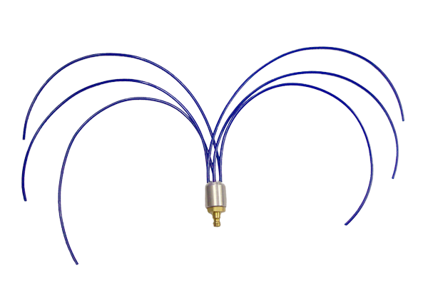

Thinking about something like this on a stout air hose.
Then maybe go big on the other end with some type of dust collector that I can use for later projects.

Piece of 1/8 pipe on the end of a fairly stiff hose with a ball valve, 2hp compressor. The volume from a 2hp compressor will dislocate any dust.
Like the idea of the 2hp dust collector :thumbup: , have it outside with a long hose. You get a free tool and save hundreds.... take that back...get a free tool and have hundreds for more tools

Pros have a huge dust collector and all kinds of wiggly things to knodust loose.
I knew I guy that built his own cleaning equipment. He had a larger air cooled rngine. About 20 HP, but I horstly don't remember for certain. But the engine was hooked up to a large dust collector fan, a compressor and generator. He would run large flex duct, like 15 inch into the houseand cut into the supply and returns, then take the air tools and run down the registers and cold air returns.
The only issue with a smaller 2HP dust collector is you can do only one 6 inch duct branch at a time. You can't move enough air to keep the dust and debris suspended if you try do more than one duct.
