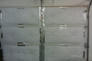

Just my $0.02 but Home Depot sells a kit online made by Owen Cornings. Each kit does a single width garage door and costs about $70. I did it at my old house and am going to do the same for my new house.
The kit has R8 pre-cut to common sizes to fit between the rails of the garage door. Each panel has 2 adhesive hooks to hold the pieces together. I found it wasn't quite sufficient so I bought some aluminum tape and taped around all the pieces to keep them in place.
Some pics of my install:
If nothing else it makes the garage door quieter but seemed to make a difference.

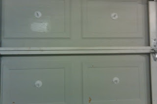

Wingnut, I am unable to see your pics because you exceeded your band width. Hopefully I will be able to tomorrow. I am in the process of insulating my door. I used the 3/4" 1'x4' white Styrofoam sheets from Lowes.
I glued the ends and the joints with white caulking. I ran short but so far it is coming out better than I thought. It makes for a nice clean install. I cut three sheets at a time with a hacksaw blade. If I can find some 1/2 sheets, I might come back with a second layer.
