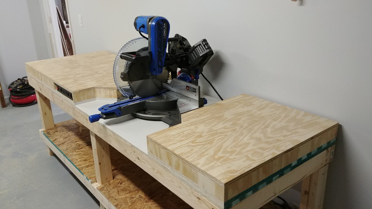

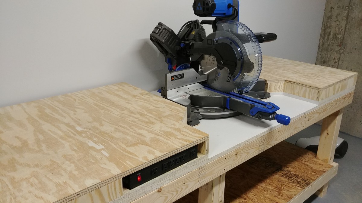

I got this Delta sliding miter saw:
It has articulating arms instead of rails (like the Bosch) and I bought it with the intention of building a miter station.
I did it on the cheap and it turned out better than I'd hoped:
I have construction pictures, but I won't clutter up the post with them unless someone asks to see them.
One sheet of ply, two sheets of OSB, and I think 10 ordinary 2x4s, plus that outlet strip and some glue and screws and stuff. Worked out well, I think.

Looks like a smart design!
How do you like the saw? I've been wondering if it's worth upgrading from my DW779.

Any plans to add an extended back fence with a flipstop? It'll give you repeatability that will save you a lot of time on projects.
Thanks. :) It's basically a flat bench with two torsion boxes attached. I did it that way so I could shim the boxes to perfect flatness when attaching them.
It seems high quality, but I just got it, and built the bench around it as soon as I unboxed it. Haven't really put it through its paces yet. But everything is silky smooth, with no bumping or rattling like you get from operating a cheap saw.

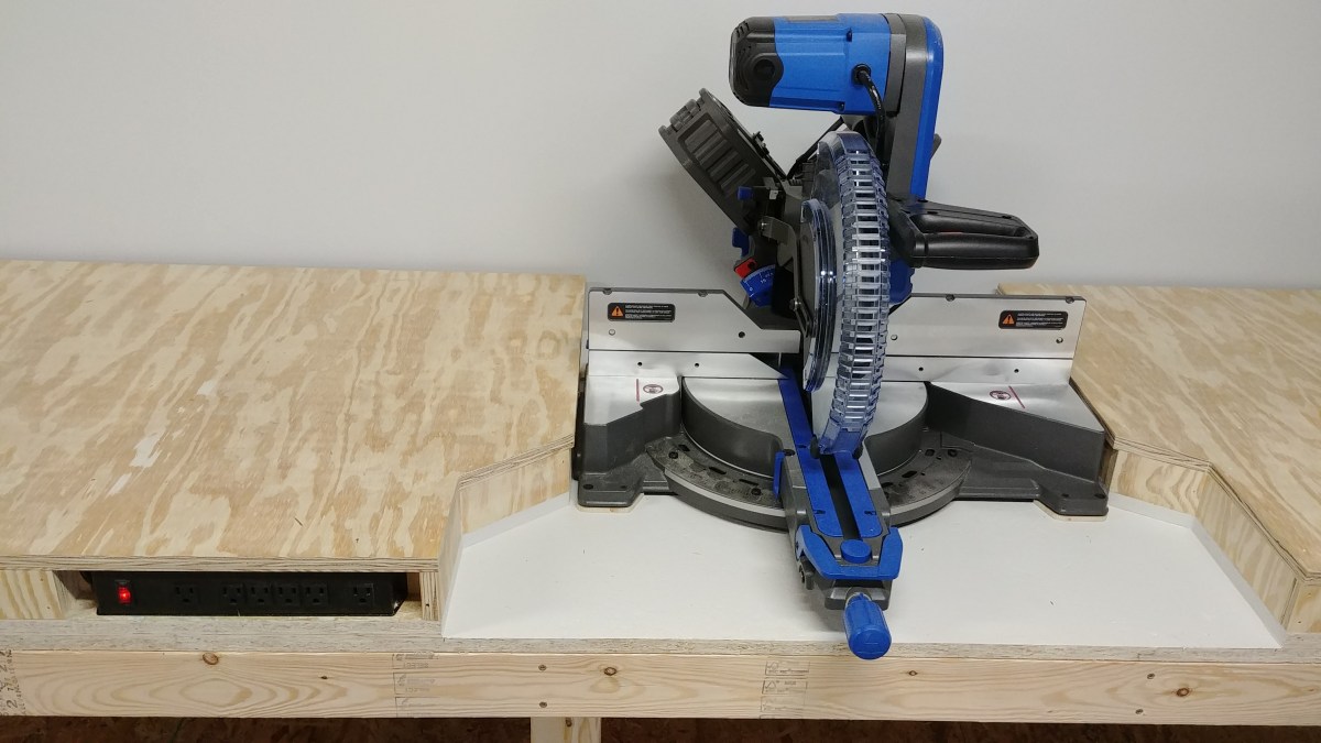

Yes, in fact, I plan to do exactly that. I'm still working out the design in my head.

What I'm thinking of is a braced L-shaped rail that sits flat on the benchtop, with pegs on the bottom that slot into holes in the top. I'll have to experiment with it a little to see if that will be stable enough. If not, maybe a couple of flush-mounted T-nuts and wingbolts to lock it down.
The idea is for it to be removable so as not to obstruct the benchtop for other uses.
