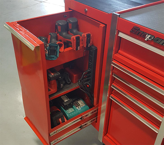

Found on Reddit... It's a pretty smart idea for building your own power bank. The fabrication could have been cleaner, but the idea is pretty solid.

I must say, I was a little shocked this afternoon when I got on and saw my project on the front page of GarageJournal.

Knowing of a near total loss home fire due to a battery charger and another that started smoking enough to set off the fire alarm on a commercial jobsite, there is no way that I'll leave my chargers plugged in and unattended.

I saw an experimental LiPo battery burn from over charging at work. It was in an open bay, in a flame cabinet and in a battery bag. The flame cabinet worked but the bag did basically nothing. Makes me want to set something up in a flame cabinet. Mine are plugged in all the time.

Exactly whats wrong with the "fabrication"? Looks great to me??
The facia of the drawer itself looks heat warped to me... Certainly a foot in mouth moment. And I apologize for being judgmental.
I do agree that I am not the happiest with how much the face distorted when I tack welded the face. I tried to get it almost completely straightened up before sending it to powder coating, however, it obviously had a little too much pressure on it because it distorted back a little bit when they put it in the oven.
I haven't done a lot of sheet metal fabrication in the past so there were definitely a few learning moments along the way.
Its FAR from perfect, but I think it does its purpose pretty well and will continue to do so for years to come.

I don't know. But it made me a bit nervous. And it seems people recommend not leaving them unattended but that sort of defeats the concept. It was a pretty intense fire for the size of the battery.
I can say this. I don't watch my batteries charge. In a toolbox or not. I try not to leave them on the chargers for long periods of time, but sometimes they'll sit there for a week or more. At least the modern chargers stop charging when the battery is fully charged.

Just plug them into a power strip and put a timer on it. Charge them 30 mins a day. Always charged, never overcharged, don't get a chance to heat up.
