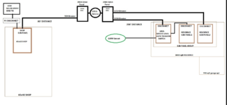

This seems like a great place to ask - I am planning on adding solar and a generator to my house in TX, and @dcg9381 , your comments about adding one and the inverter "Switch" is causing me some concern.
I have a 320a service to the property, set up with two 200 amp switches. One is dedicated to the house, the other will be split with 125 amp breaker to my shop, and another 125 amp to the house as a secondary panel.
I want to run grid tie, with the solar mounted on my shop. My understanding is that this will allow for the power to be fed back to the meter via the wire ran to supply the shop.
I also want to set up a whole home generator (for the purpose of the explanation) next to the meter, and have that feed the 200a house feed (AC/heater, lights, stove, etc) for back up power, on an automatic transfer switch.
Is this possible with currently available DIY setup? I was planning on DIY setup for the panels and inverters, and having a solar installer/electrician come in and handle hookup to panels, and the generator.
I have exactly the same setup. 320A service, split 200A panels. 200A to the house. 90A to the shop.
Same thing, I have solar on the shop. Our ATS/generator are downstream at the house. Basically generator power only covers downstream of the 200A main breaker that feeds the house. Shop solar back feeds via the 90A main.
The downside of this is that there is no generator backup on the shop. If you can live with that, it's pretty easy to do.
For power backup on the shop, I use a separate 10KW generator and an interlock. The interlock turns off solar and grid power. Then I can manually start / plug in the generator.

Thanks for the info! That is how I imagined it working, but your post above had me confused. It looks like your setup is almost identical to how mine will be laid out, that is a ton of help!
I too am OK without power to the shop in an emergency, and will do the same with a separate generator and interlock if needed.
My neighbor at my current house is an electrician and will be handling the generator setup and much of the wiring I dont do myself at the shop, and as long as the generator setup can be downstream on the house panel separately so I dont have to worry about back feeding and having the panels go live, I dont mind the manual aspect or solar install. I also know an installer that did my parents house, and he has changed careers, but has told me he will be able to help if I need anything, so hopefully we can get it all done.
