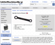

One thing I would suggest when you start using your mill is it's variable speed. Before turning the mill off, I always drop it down to the slowest speed. If you don't do this, It will make a loud pop when you turn the mill back on. There's a toothed belt that turns the spindle and my thoughts are you are going to increase the life span of the belt by reducing the speed to the slowest setting when turning off. A higher speed start creates the loud pop sound and increases the stress on the teeth of the belt. Just my 2 cents from having one for a long time. I would also highly recommend getting a Spindle Spline Wrench. It will make changing collets much easier
https://littlemachineshop.com/products/product_view.php?ProductID=4803&category=

The spindle spline wrench that Little Machine shop sells and the factory hex wrench for loosening the drawbar. The drawbar on my mill had a flange above splines that prevented using the wrench. I had to machine off the flange to make wrench work. They might have changed the drawbars on newer X3's so you don't have to do this
