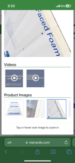

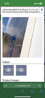

Termites were eating the heck out of my foil faced Johns Mansville insulation board in my pole barn. Luckily it was only a small area before I noticed it. I am now forced to termite treat the building. My dad was an exterminator for 40 years and he was surprised the product was made like it is. Must be some kind of paper fibers used in the making of the insulation board. Do yourself a favor and DO NOT USE JOHNS MANSVILLE INSULATION BOARD

Assuming it's polyiso, any polyiso product would have had the same result. Foam is foam
