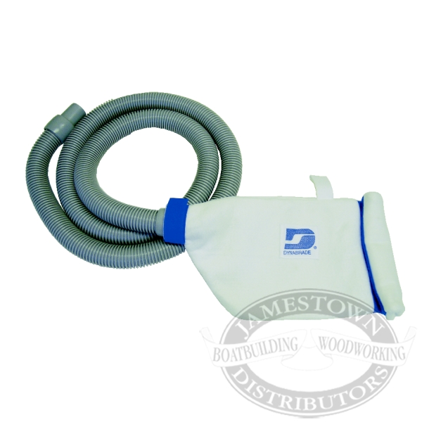

I recently picked up a barely used Dynabrade 21039 sander.
I do not have a means to any powered dust collection, at least not at the moment. I can convert the sander over to self vacuuming for about $20 in parts, and my pads and paper are multi hole already. I can buy the 6 foot hose and bag setup for about $40.
I guess I'm just curious if it's worth the trouble? I've never had a self vacuuming setup, so I'm not sure how well they work.

yes, it is worth the trouble, especially on large flat surfaces...it reduces the amount of dust, it helps to see what you are doing and monitor the sanding progress , overall work environment is much more cleaner, plust the job is done faster and sandpaper cuts better.
i use them in the body shop on daily basis....i have 3M self vacuuming sanders with a bag, similar to the picture u posted and i use 3M Clean Sand type of sandpaper with multiple small holes...
if you go with a vacuum system, it is even better.

What he said. Yes, they collect a lot of dust. A lot escapes too. A real vacuum will collect more dust, but sometimes that's not an option.
Oh, and yes, it really only works on flat surfaces. If the paper is lifted off the surface (as it has to be on a curve) the dust gets out that way as the suction is pretty weak.
