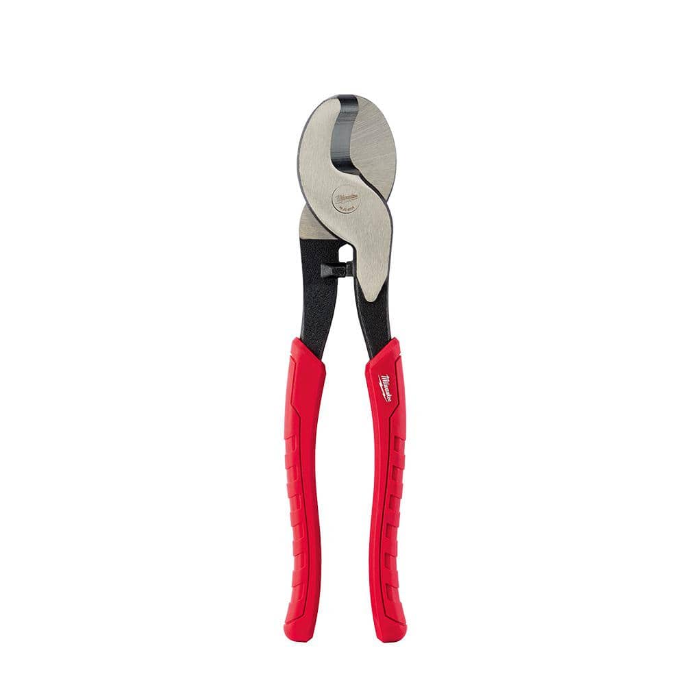

These milwaukee parrot style head cable cutters are my new favorite. Cutting 12-3 romex with them is so much easier on your arms. Plus they can pretty nicely cut hose and many other things.
They also make fairly decent striper's for bigger cable. I've been quite impressed with mine especially as I bought them after recoiling in shock looking at the price of ratcheting cable cutters.
