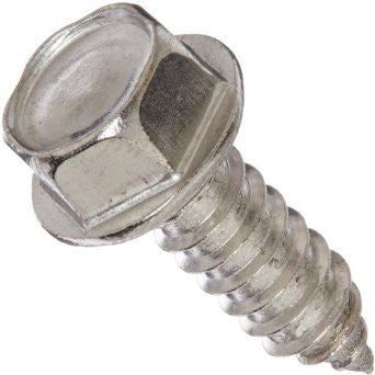

I like nut drivers. I run across screws that are both Phillips and 1/4" external hex, which is nice in case someone has striped the Phillips recess. It provides a second way to remove the screw, and it can take more torque. Cordless/electric drivers have their place, but sometimes can be too bulky, or are prone to slipping/stripping. I have found that nut drivers are quite useful for certain automotive fasteners (like headlight brackets), HVAC maintenance, appliances, some electronic components, computers, etc. They can be faster than a socket/ratchet, and not as easily lost (looking at you, Mr. 10mm socket!). Magnetic nut drivers can also be a great option for starting screws or bolts in places even if you need a socket/ratchet or wrench to finish up.
