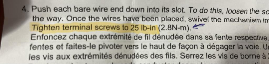

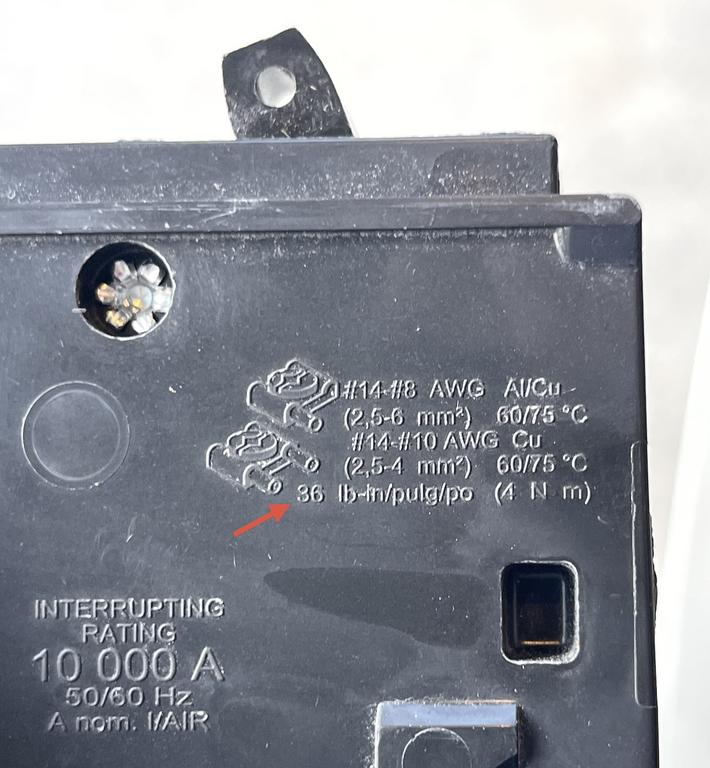

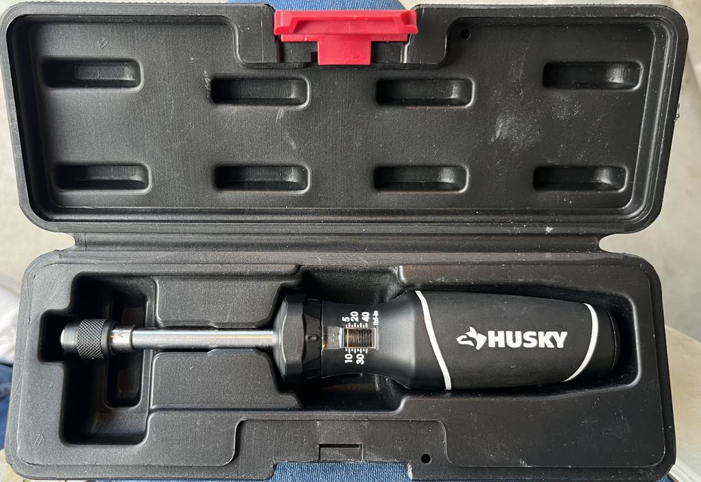

I’m wiring a new 30A RV outlet and am using the torque specs for the box, the breaker, and the outlet. I even confirmed my 8-40 in-lb torque screwdriver was accurate against my two Sturtevant Richmond lab grade torque wrenches. All three matched.
I’ve never bother if replacing an 15 amp outlet, but I will torque connections for 30 and 50A circuits. The question is if you torque electrical connections.
Breaker
Box
Outlet

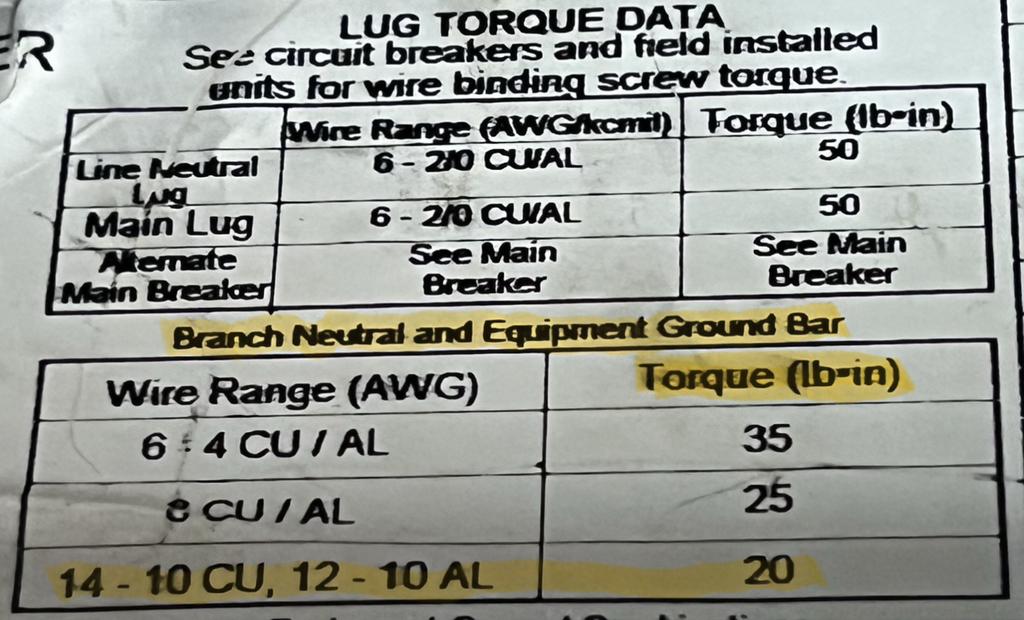

I’m not an electrician either so I don’t have the calibrated wrist from doing this everyday day so I will use a torque screwdriver if I think it’s important to do so.
I’d never go with a “he said” torque value on anything and I fear that your lugs may be way overtightened. There should be a sticker in the panel box that indicates all of the connection torques used in the box. You may want to pull the cover and check that sticker. Everything I’ve ever touched in my house was in INCH pounds and could be tightened by wrist with a torque screwdriver. The main lines into my 100A Square D sub panel is only 50 INCH pounds which comes to 4.1 ft-lb (shown below).
The torque on the main lines on a Square D 200A Main panel is 250 INCH Pounds which is 20.8 ft-lb.

I had a panel replaced and the electrician was using a torque screwdriver. I was impressed. . I don't have a calibrated wrist and I do have a desire to buy new tools so I bought a torque screwdriver when later I was adding circuits. Since I needed reading glasses to see the small print on the side of the breakers and I have a short attention span I started writing the spec on the panel with a sharpie. If anyone ever questions the work at least they will be impressed or maybe scared that it's full of notes about torque spec.

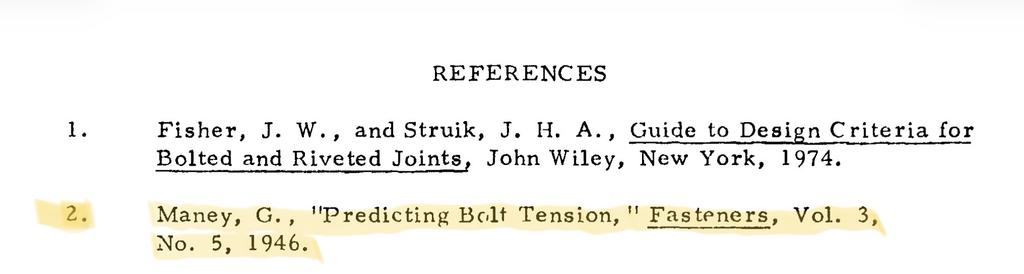

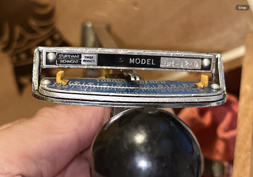

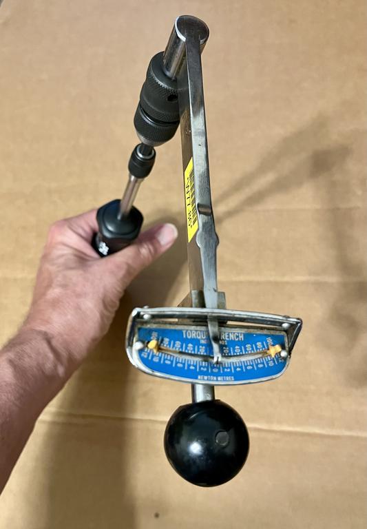

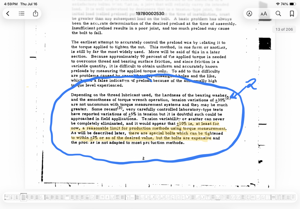

I like these old pdf engineering docs. The accuracy range in general is what interested me. Particularly with the time some spend on getting precisely calibrated tools.
The 30% shown is from reference #2 which is a paper written in 1946 that was one of the first studies on bolt tension because industry was moving from rivets to high-strength bolts.
In the 1977 paper you referenced it indicated that 10% was a reasonable limit, for now, and that expensive bolts with 2% accuracy were available in 1977.
I also read that the applied torque in electrical connections generally fluctuates by ± 10% to ± 20% due to friction and the limitations of the torque tool being used. Square D designs their terminals and clamp plates to accommodate this variance securely.
Since friction adds variation why would you want to add more variation with an inaccurate torque wrench?
I read that NASA uses very accurate non adjustable, single torque, torque wrenches for electrical connections.
bluedog225
Jan 31, 2012
3,393
Texas
I’m not an engineer.
But with the 30% range your cited source seems to endorse outside of “very carefully controlled laboratory-type tests”, doesn’t the precise accuracy of the tool becomes significantly less important?
That is, folks looking for 5% accuracy in their garage torque measuring tool are not getting anywhere close to 5% accuracy.
Keep reading, the next sentence indicates 10% was a reasonable limit in 1977.
The 30% was referenced from a 1946 paper.
Would you want an inaccurate torque wrench to make it more?

Keep reading. For “production methods” depending on the thread lubricant used, the hardness of the bearing washer, the smoothness of torque wrench operation, etc.
I believe the term “production methods” refers to an environment where many variables can be controlled. Not every day handy man projects. Diy electrical doesn’t strike me as a production environment.
S
Shadowdog500
Dec 7, 2009
9,939
Down the shore
That entire sentence was a reference from the 1946 paper.
I don’t agree, but I’m not going to debate this with you any more. Apparently that paper has you convinced that a torque wrench is not needed for anything. Even for head bolts! Just tighten it until it strips then back it off a 1/4 turn! LOL!
I bet the range is a lot more than 30% without a torque wrench.
