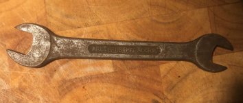

outofbounds
Oct 23, 2019
1,393
Yes. Located in Santa Monica Calif., having three contracts worth $512K between 8/44 and 5/46 with the US Army Ordnance Dept for "Engineers Wrenches". And, not surprisingly, every example of an Arcturus tool I have ever owned or seen has been an engineers wrench with its Federal Stock Number forged-in on the shank. EDIT: Infamously, no example of an Arcturus 723 (3/8 x 7/16), the smallest in the 5-wrench set in the on-board tool-set and 6-wrench set in the GMTK, has ever been seen.
Looking for a place to drop this wrench, found in my latest "box and contents" dalliance, and this seems as good a place as any.... 25/32" x 5/8". Interesting thing to me about this example is that the 25/32 side is a decidedly different shaped head than the much rounder 5/8". I have inspected it closely and would aver to the fact that it has never been altered.

A couple of mine.
Interesting, Don, seems yours feature the similar distinction of having different head shapes at each end, except your the larger sizes are "rounder".... Wish I'd found this wrench a week ago, I'd have sent it packing in your direction.
31,054
Arcturus wrenches are renowned for two things: FSN's, and their odd shapes and anomalies. Look at the way the ends of the top wrench in this group was milled.
Not unexpectedly. They were a small (* to say the least, see footnote below) company started in late 1944 to explicitly take advantage of the war machine and the coming Cold War and Military-Industrial Complex, and DOE wrenches was their only known foray into hand tools. Point being they didn't have a lot of tool and die experience.
They had their forging sights on bigger fish. Better said bigger birds (Aerospace), a field they plied with small special parts through at least the early 1980's.
The name comes from the Arcturus Zone, which was the name given to the rich Quaternary oil deposits of the alluvial plans in LA County (Le Brea, Santa Monica, etc). Arcturus Oil Company, HQ in San Francisco, had hundreds of wells there from 1915 through the 1930's, and I think Arcturus Mfg may have been associated. I have to double check my notes.
* A 1950 article in the LA Times about their expansion, after a massive Northrop contract, says they started in a "tin shed" in 1944.

outofbounds
Oct 23, 2019
1,393
What a fantastic and colorful background that you've worked up for such a modest little company! Thanks for that.
