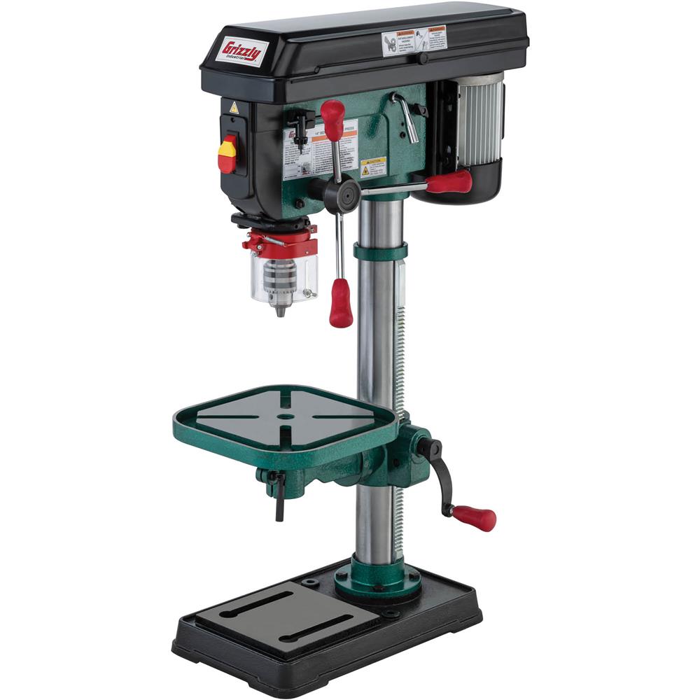

Grizzly T33959 has a 4 11/16" spindle travel, 1 HP motor, two belt drive system, and 15" swing. It's essentially got the same power head that they use on their T33960 floor model, they just sell it with a shorter vertical column so they can call it a benchtop.
But then, you're going to pay almost the price of the floor model, of course.
