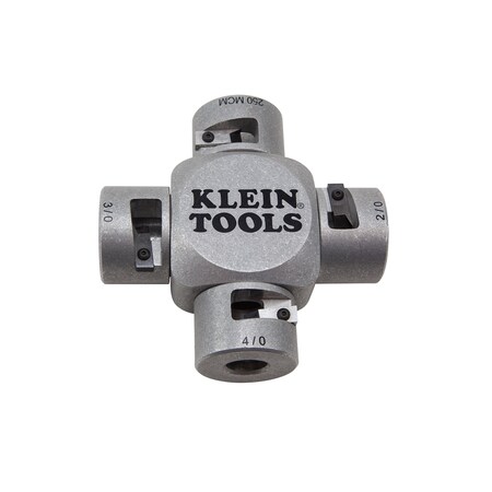

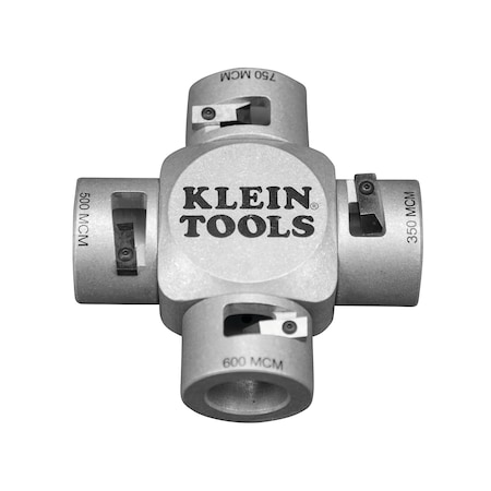

Nobody needs strippers. There are several other tools that could be substituted. However, I wouldn't want to be the poor guy tasked with installing 75 receptacles, 20 switches, and 15 light fixtures by the end of the day using a pair of cutters and a knife.
Nobody needs a car, there are other modes of transportation from taking a bus on down to walking.
EDIT. It's personal preference, here's what I prefer.
#16 and smaller, I use a pair of plain 'ol dykes, occasionally linesman pliers, but 99% of the time, it's dykes
For #14, 12, and 10 I use strippers. The same style Ideal T strippers that were popular when I started a long time ago
I do have a set of multi purpose pliers with a #8 hole, but have never used it. #8 through 1/0 gets stripped with my Greenlee 727 cable cutters.
And finally, Klein has a stripper for wire larger than 1/0. I have the set from 2/0 through 250. I doubt I will get the larger set as I have no interest in working with that large of wire. Someday it may happen and I might buy the stripper. I might also use a skinning knife.
