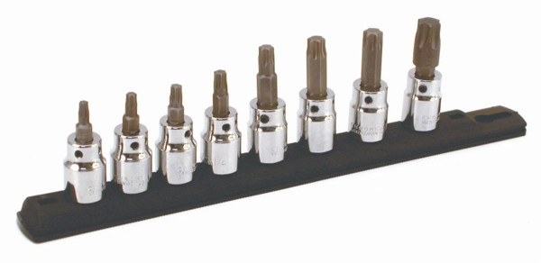

I've noticed the Lisle bits are flat on top while other bits are flat only in the center of the bit... does this give any sort of advantage? Perhaps this is why my fastener almost stripped.
Lisle bit...
Wiha bits...
And just for comparison... Snap-On bits.
Lisle bit...
Wiha bits...
If you look closes at a torx bolt. They are a bit rounded inside. So rounding the top of a torx bit lets the bit sit deeper into the bolt. So you have a much more exacting fix, and in high torx applications less chance of stripping out the bolt.
Cheaper torx keys, bit, and drivers do not round off, while the more expensive ones do.
