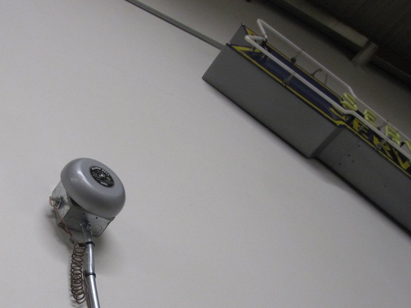

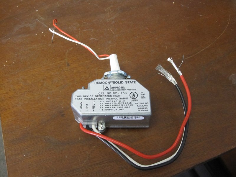

Mickey O
Oct 25, 2009
6,153
Chicago, IL
Believe or not, I just did the very same thing the other day (pics below) at the garage. I used a Remcon relay that has a transformer built in, I used thermostat wire from the door bell button to the relay that's in the same box as the first bell (the other bell is on the other side of the wall). In my case I used 120 volt bells so you may not want to go that route, but if you do just get a Remcon RC-120S. The only issue is the bells only ring while the button is pushed (whereas an actual doorbell rings a couple of times from one push), you can make it ring longer with a time delay relay if desired.
