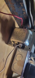

So our house has 2 doorbells. The front one was hooked up to a camera that functioned correctly. Tonight I tried hooking up one one the rear door. Some how I managed to knock out the power to the front door and now I have no power to either door. Any quick help on which wires would go where on the transformer? I've never dealt with doorbells before. The 2 wires that are still hooked up were always hooked up. Just cant figure out all the others20220714_203840.jpg20220714_203853.jpg

You might need a bigger transformer, I can’t tel L what voltage it is other than 20va and it have 3 voltage outputs At 24v 16v and 8v the C is common for those 3 voltages.
20va is pretty weak at 16v it’s barely 1.25amp , probably won’t power up 2 camera and door bells.
Find out what total voltage amp requirements for your camera and door bell needs and over size it by at least 20% and get a new transformer.
I used a 24v one from hvac @40va off eBay for $10. but ymmv you know you and you do you situation.
If you need to test your current transformer.
Get a multimeter put in ac voltage mode, one probe to the C terminal and verify the corresponding terminal output the correct voltage.
Yes you have a chance of burning up a transformer by overloading. ( should clarify this, it should read your transformer could have go bad from overloading as well, troubleshooting starts with testing voltage output.)

First test that the transformer has output voltage - you may have damaged it by overloading. Although that doesn't really matter as it looks like you need a larger transformer. Here's a Ring page on wiring for various setups - other brands should be very similar. It recommends 30VA for 2 cameras. Bigger is better so going to 40VA would be fine. 16 V is common for doorbell setups. Before going to 24V I would check that the cameras can take it. I would stick with 16V with larger VA if you want to keep the existing bell.
https://support.ring.com/hc/en-us/a...ng-Diagrams-for-Ring-Video-Doorbell-Pro-Setup
That's a lot of wires! Was the rear push button working the bell properly before trying the camera? If so you should be able to just use the same connections. If not you need to figure out what wires go where. You could, with the transformer disconnected, short the wires at one end of the runs and use an ohmmeter to measure resistance at the other ends. With multiple tests you should be able to figure out which wires go where.

Your transformer is barely big enough. It's rated 20VA which would mean you're drawing 100% of it's rated power to run 2 cameras that are rated at 10VA each. Get a bigger transformer as has been suggested or get a separate transformer for the second doorbell. Then follow the advice above to trace your wires with an ohmmeter.

Yes that and just remember transformers are not 100% efficient especially door bell ones.
also forgot to mention the voltage drops... on thinner smaller wires. So, as long as your wiring are in good shape, going 24Vac might be a good idea anyways.
